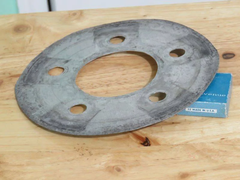

I'm not at all sure I'd want to remain blissfully ignorant of 3+ mm worth of wheel flexing and/or runout due to hub bearing play.
For just under 1 mm at the caliper face, I'd probably fab up thin spacers from something like 0.025" thick aluminum sheet.
