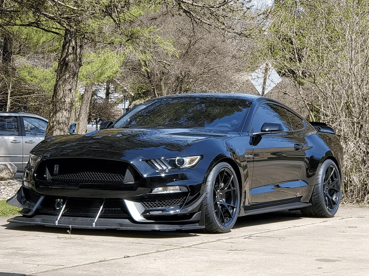

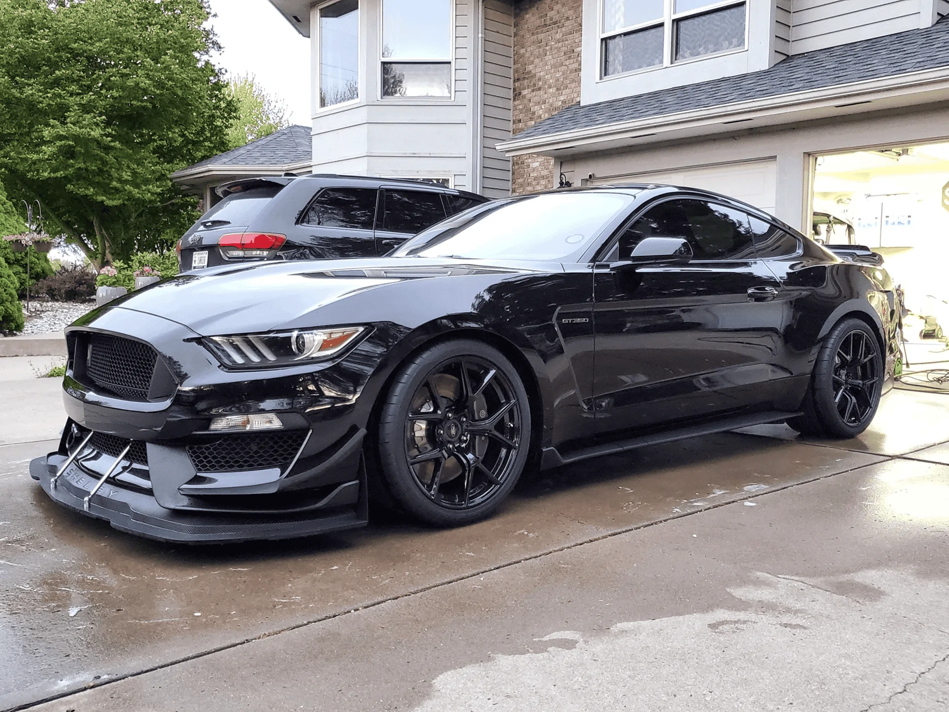

Actually for one of my sets I use the lmr sp2 pp2 replicas in square and rotatable 19x11 50mm offset using extended front studs and a 1" spacer. barrel to caliper clearance is very good. I like the look of the 6gr 10's better though and the little scrapes from the caliper clearance being tight don't really bother me, they are coated in brake dust and cant' see it most of the time anyway haha
sp2:
6gr 10 also square/rotatable:
