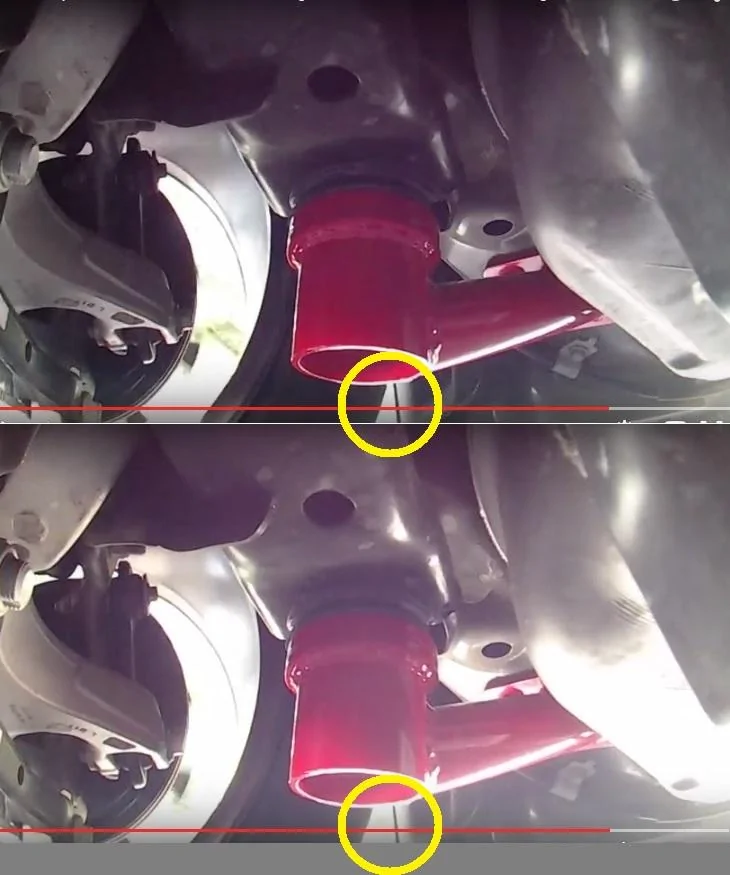

Here is paused footage from an undercar GoPro that shows the fore movement with stock LCA Bushings. Notice the position of the wheel/tire in the fenders when under load, then not under load. It is even worse when racing the car on a drag strip or road course, or during heavy loaded spirited street driving.

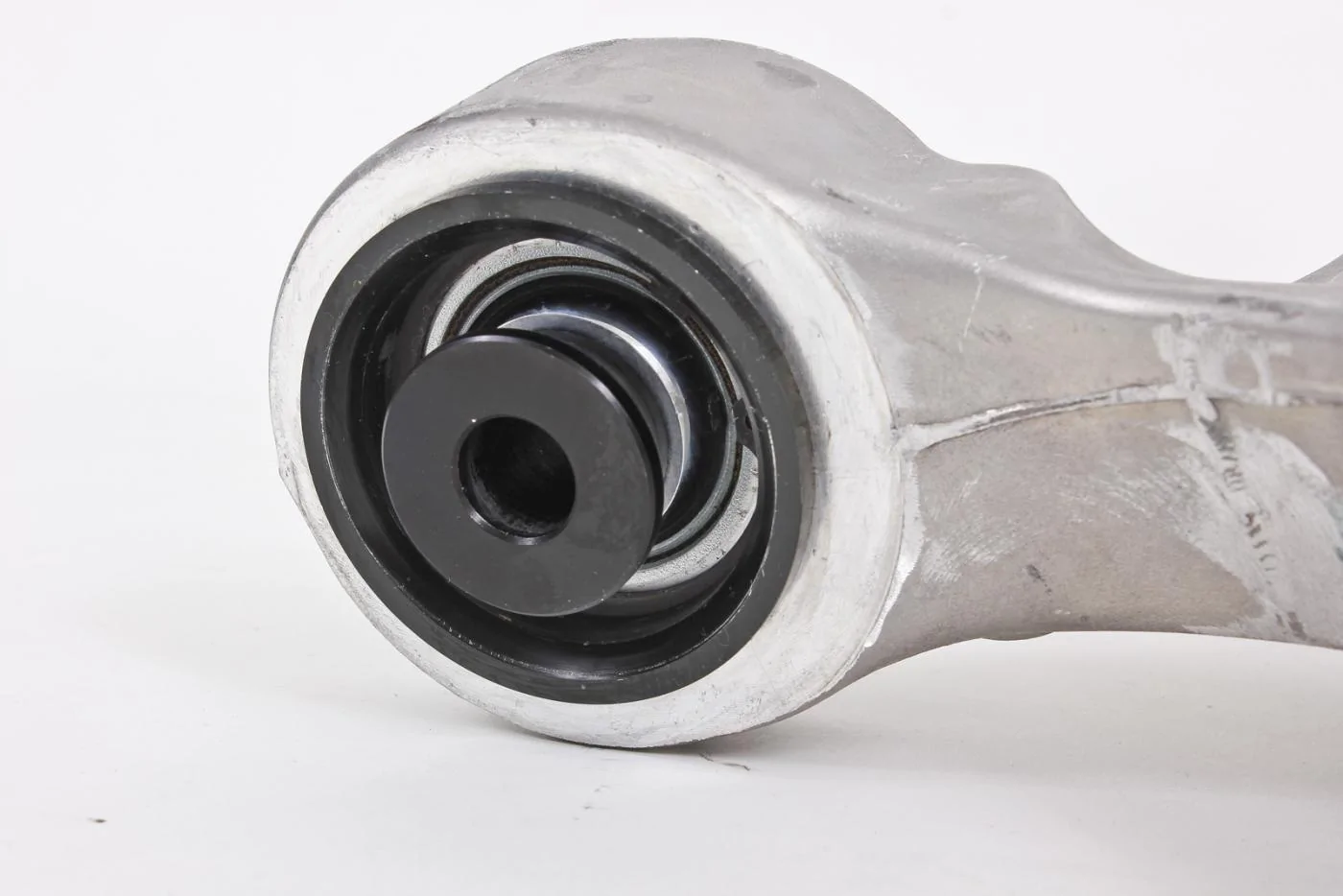

Yes, those are our BK055 Bearings.
They are very popular and have had many people saying "damn, I wish I would have done this mod first before anything else"
