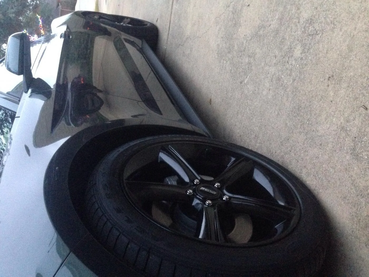

Due to american muscles cyber Monday sales I ended up pulling the tigger on some oem style black gt wheels for my 2015 v6 because it's hard to pass on $99 19" wheels. Anyways I've looked around and I can't really find a solid answer if they will fit properly. They are 19x8.5 with a+30mm offset. And if they will be fine has anyone tried to put 245/45r19s on our s550? Because I think the factory size is 245/40r19

Wheels came in so I went on a whim and couldn't be happier, these were on american muscle under 05-14 wheels and they fit our 15's!

No they are actually almost flush with the top of the fender maybe less than 1/4" inside, I don't think it could have been a more perfect fit no rubbing or any issues over bumps :)

Awesome! I have a pair of front rims that are +30 offset. Good to know it'll sit flush
