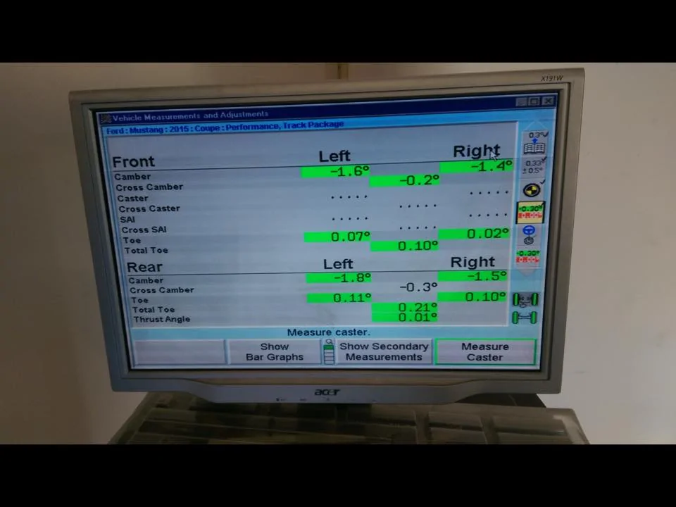

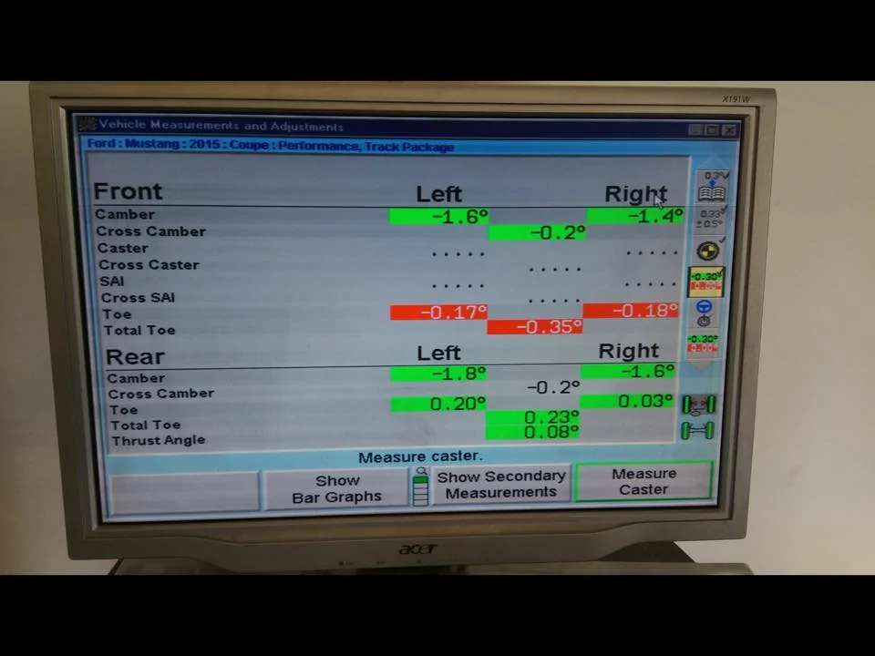

Todd15Fastback
Dec 10, 2013
80
10,523
3,883
Atlanta, GA
Todd
2015 Mustang GT PP Fastback
No issues either. I just a ton of Steeda suspension parts installed and they aligned with no issue. Only took 15 minutes to align it.
First picture is before alignment, second is after.
DR_
Apr 7, 2015
669
261
In a van down by the river
David
like a complete jerk
Since I bought the car a little less then a month ago I had a slight alignment issue. I have to keep the steering wheel about 10 degrees to the left in order for the car to go straight. If I hold it straight car starts going right.
Went to dealer last week and they hooked up the units to each wheel and said my alignment was fine so it must be something else... I came back today and dropped it off, got a call about 2 hrs later saying they threw it on the actual alignment rack and found out they don't have a profile loaded in the software for a 2015 mustang and said to come back in 2 weeks and they'll have it updated by then.
Anybody else have a similar issue/experience? I just find that all very strange since the car has been out for a good amount of time now.
You can program in custom settings to pretty much any alignment rack. That dealer should just look up the 2015 specs and plug them in as custom settings. Everything is pretty self explanatory for anyone halfway familiar with alignments except the camber on the back. It doesn't look like a typical eccentric bolt and is easy to miss.
DR_
Apr 7, 2015
669
261
David
They didn't find your rear camber bolts.
