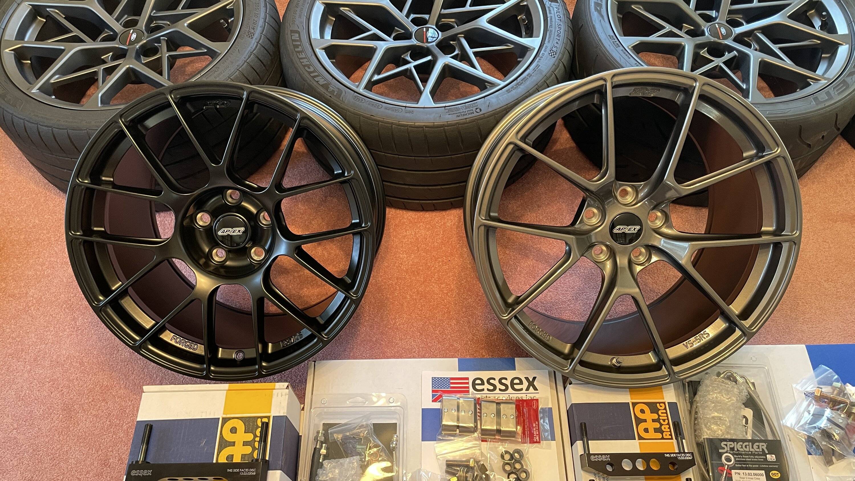

My recommendation would be a square setup from Apex, Apex spacer and ARP front studs. Forged 19x11’s are 20.4lbs. That 18x11 on the left is 20.0lbs. Their website will has a great link for fitment.
Thank you so much sir.
