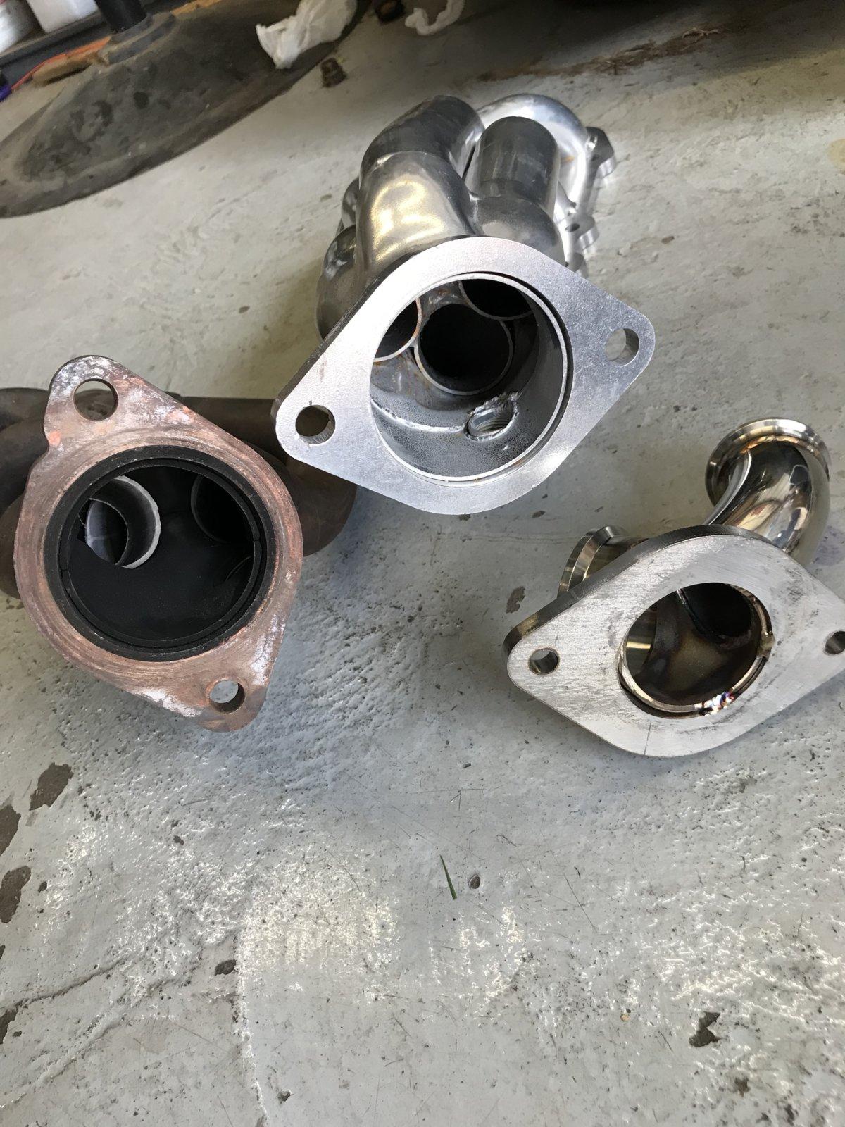

The back pressure issues with the LPF kit is the adapters on hot side. To small. It is a well known issue. The owner has denied it is a problem while customers were dealing with it. But....secretly fixing the issue with better adapters. Let me find some pics of these adapters.

This pic should be self explanatory. In this pic we have 2 different headers. Stock on the left then a aftermarket shorty header. The piece on the right connects to the stock header with the LPF kit. Look at the inside diameter with the adapter. THIS is the cause of the lpf back pressure issues everybody has been fighting. Like I said in my previous post I believe he has now learned a lesson and improved his kit. It is not the stock headers making the back pressure issues. Hope this helps.

Good information.
