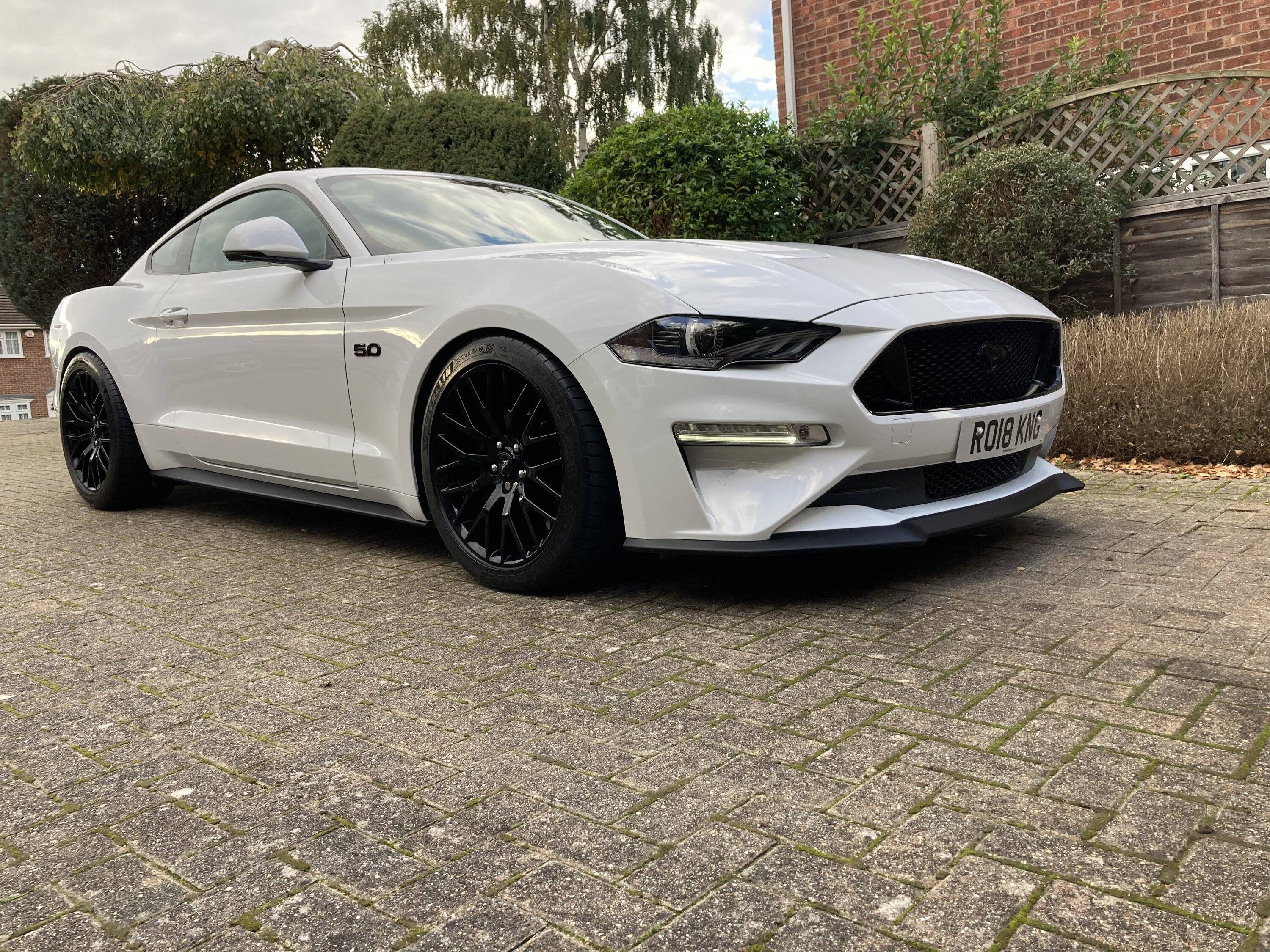

2018 GT
I have PP1 wheels on my 2018 GT
With 25 and 23mm spacers . The wheels fit the arches well
I’m looking to replace the wheels but want to get wheels that fill the arches the same but don’t need spacers or only thin ones
How do I work all that out

Subtract the size of the spacers from the offsets of the PP1 wheels, and that will give you the wheel offsets that will fit the same, (if they are the same size wheels.)
So the 19x9 front would need to have an offset of +45-23= +22. If going wider, add back 1/2 of the difference in width. So with a 275 tire instead of 255 on the front, the offset needed would be +32.
