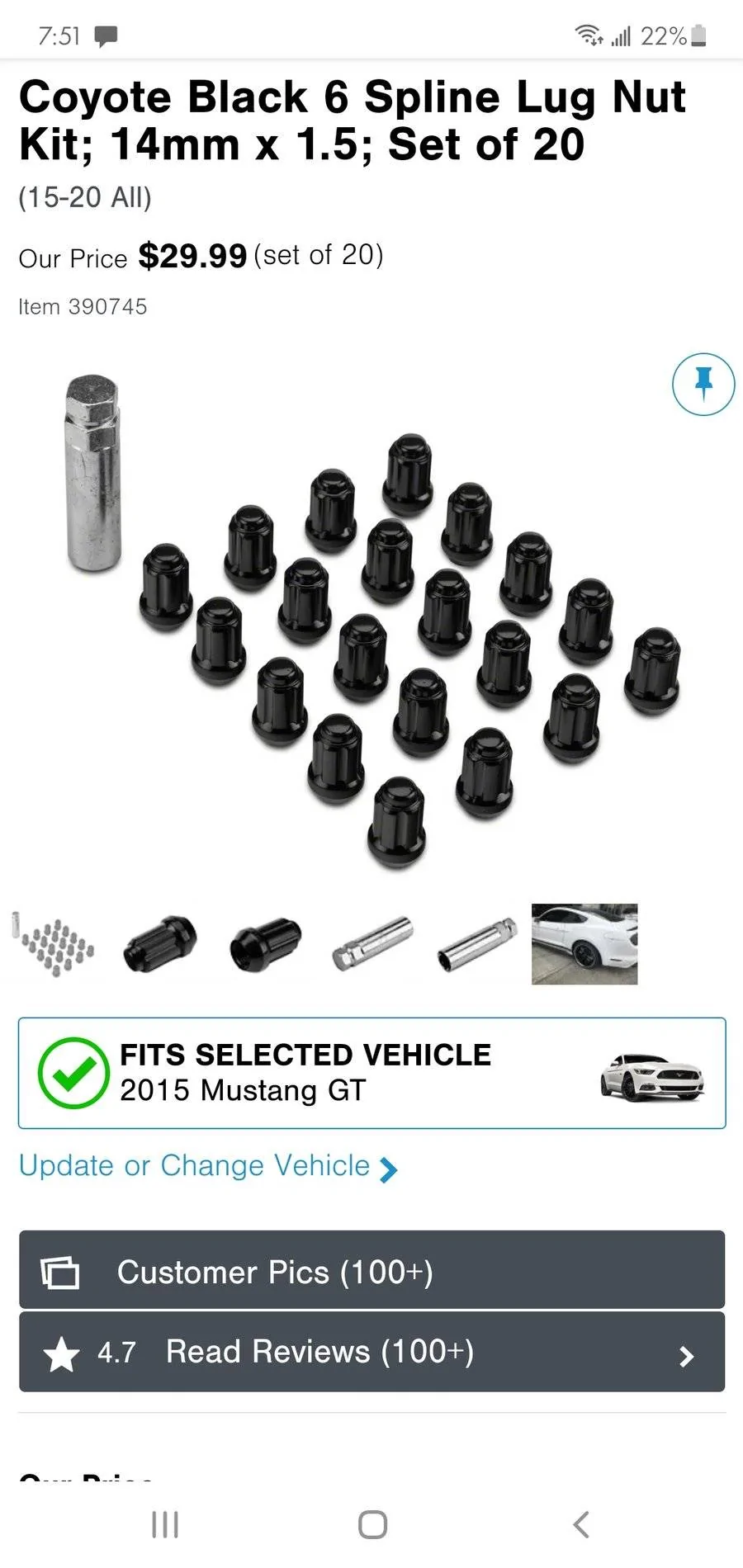

I just ordered a pair of 18x5 Forgestar D5. I was told my stock lug nuts won't work.
Where can I get the right ones ?

These were on the d5 page on AM. At the bottom where you can add to your cart.

In the end, the stock lug nuts are about 1.2" diameter seats while the 41148HT are about 0.92" seat diameter. Not sure what the seat diameter is of the splined nuts. In some cases, they are the same 0.92" diameter as the small diameter I listed. Contact the desired vendor for actual size.
When you get your wheels, get a piece of clay and stick it into the unmounted wheel lug pocket to get an impression of the lug seat. You can then measure it.
An alternative is to put some black or colored sharpie on the lug seat of the stock lug nut and , by hand, mount the wheel. When you remove the lug nut, the sharpie will get removed from where ever the wheel's lug seat makes contact. You can then measure the diameter of the new wheel lug seat.
Having too small a lug nut when compared to the size of the seat is not good. Make sure you fill it. This is why several manufacturers indicated running smaller lug nuts that do not fill the seat is not advised. I have responses from Gorilla and McGuard in those threads.
In all cases, your lug nuts will have a 60 degree cone with 14mm x 1.5 threads.
