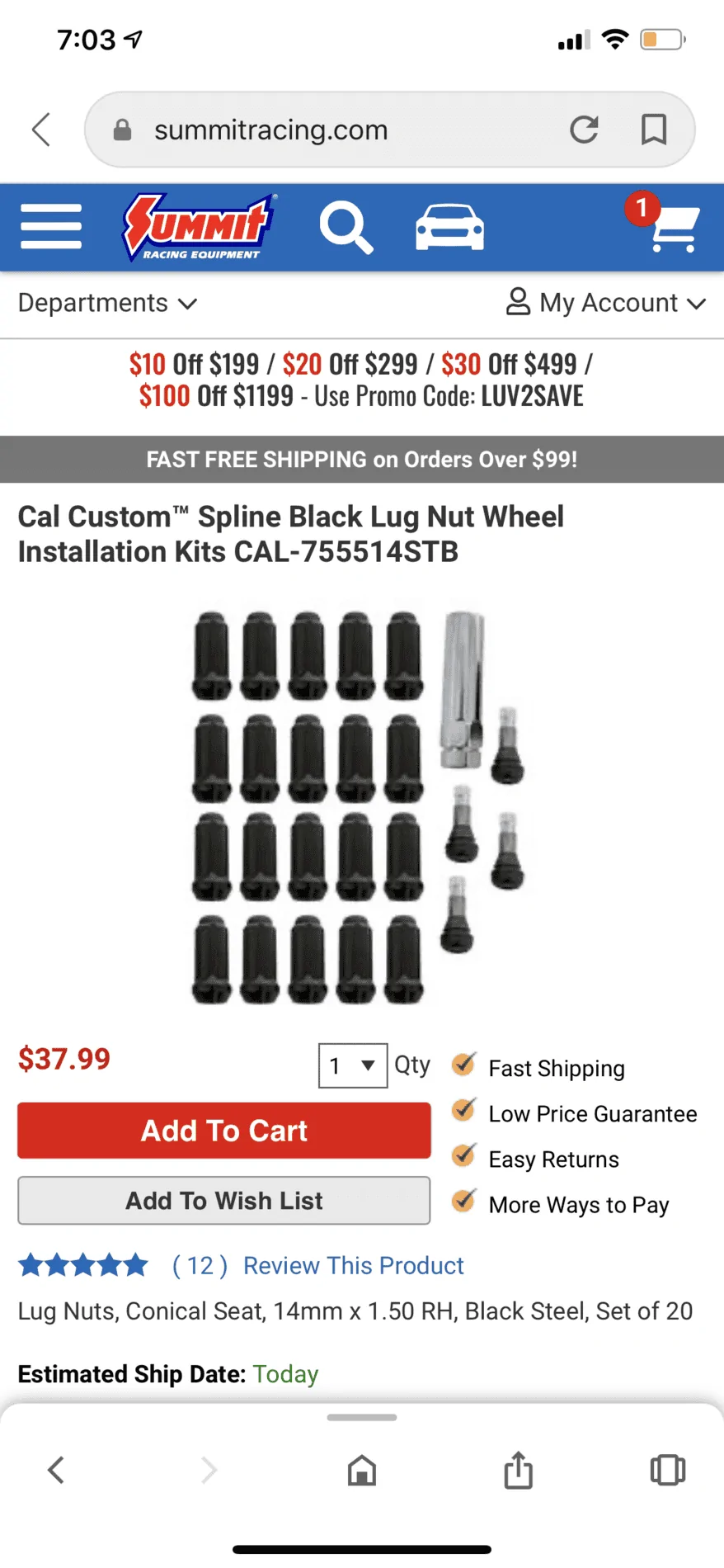

Looking for black lug nuts for forgestar d5. Anyone know if these work?

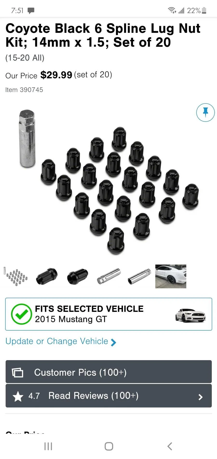

just make sure that you fill the lug nut seat diameter fully. Having lug nuts where the nut seat is too narrow is not advised. You need more than just a 60 deg cone 14mm x 1.5 lug nut. Stock seats on EOM are 1.2" Several aftermarket use 0.92" or thereabouts which need a narrow lug which can be found in small diameter Gorilla 41148HT or their splined nuts as well as several other brands. only list those for an example.

I ordered these. They should work lol
