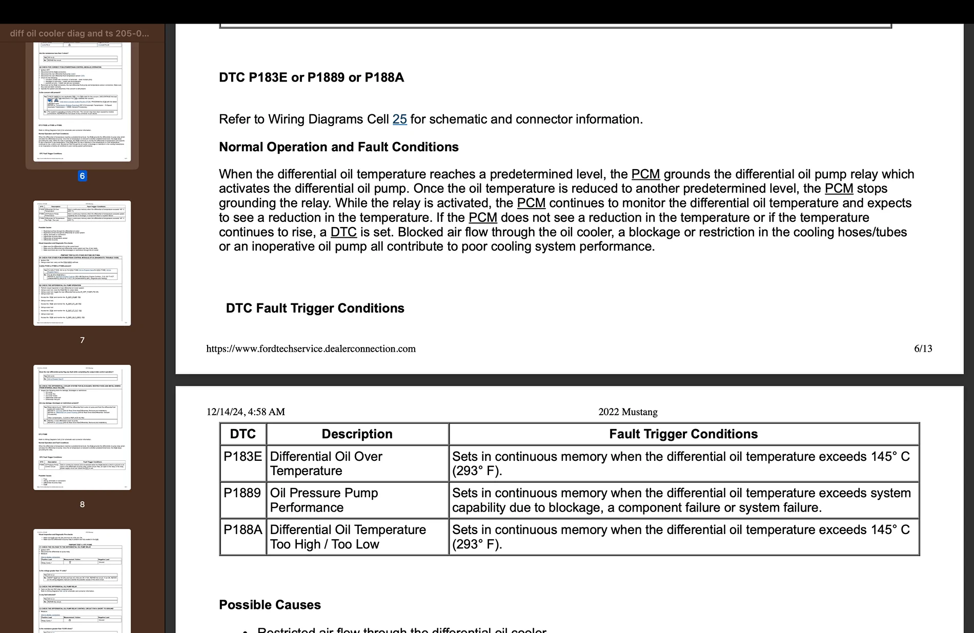

...do we know when the pump engages on Mach 1? And if the pump does not engage, is the radiator even doing anything?
I looked at a document I have (screenshot attached). IDK what temperature the fan kicks in. "Predetermined temperature", which is programmed into the Powertrain Control Module. The document is for GT500s as well as Machs and others. It does reference overheating, and when the PCM will throw a code.
Airflow from the rear aero assembly will keep fluid in the radiator cool, like in a water radiator when the thermostat is closed. The excess fluid heat from the diff will flow in the direction of the cooler. But I'd think any cooling effect would be limited. Like a water radiator, the medium (gear oil), needs to circulate, yes.
I found this part in my shady service manual too. Over 145°C writes a permanent DTC, but what is the one predetermined level and the other predetermined level is a mystery 🙂 .

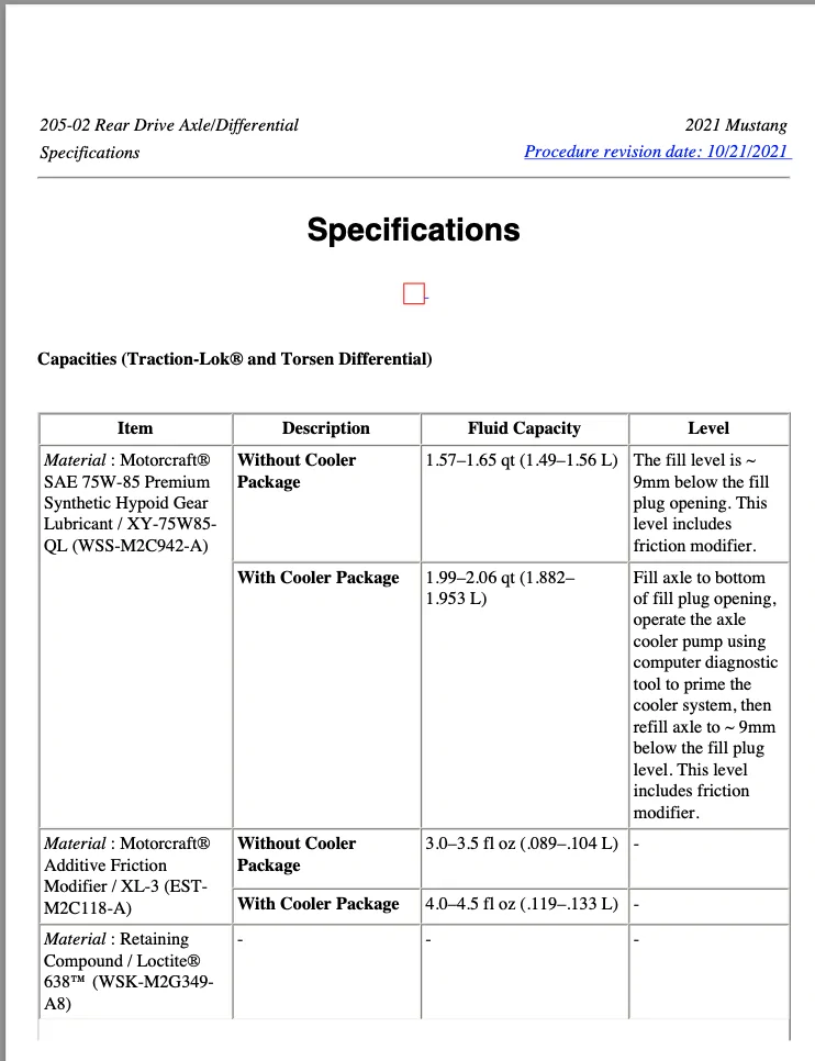

Right. When changing the oil in Tremec, one is supposed to run the transmission in neutral for some time (again to fill the radiator and the external circuit) and then check and top the filling again.
But for the diff, the manual says, run the pump for 2 minutes using a diagnostic tool...

My shady service manual says (no idea if it applies to Euro version, but it should apply to my VIN).
