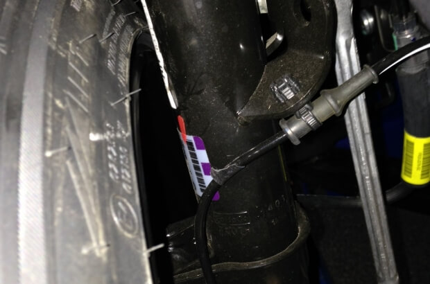

ive spent the better part of last week swapping wheels on our 2015 mustang ecoboost.. the benchmark wheel is an Advan RSD 20x10 +35
In the front (with oem camber) the inner lip is 13mm from the strut. the outer lip is flush with the fender
In the rear (with oem camber) the inner lip is 57mm from the strut. the outer lip is 6mm from the fender
our aggressive new wheel selection is Volk TE37 Ultra:
Front: 20x10 +35
Rear: 20x12 +48
this is very aggressive wheel fitment, however our penske suspension will have camber plates so at -3 front and -2 rear i think it will fit with just a little massaging...
