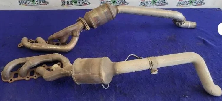

Not necessarily. What typically happens when the CEL is triggered after a LTH install, catted or not, is that the rear O2 sensor is now seeing too much flow in the exhaust. So the ECU believes there is an issue with the cats and triggers the codes. This is a somewhat simple fix with something called a "defouler." Essentially, what it does is get the rear O2 sensors up and out of the exhaust flow, which in turn causes the ECU to think your cats are working properly.
You can go the aftermarket cat route on the stock manifolds if you want. While the cats may be cheaper up front compared to the LTH', paying a shop to install them is going to be very costly. That is, even if they will do it. I'd call a few local shops and ask them about doing this. I bet you get two answers. First and foremost, just a plain "no, we won't do that." The shops that will do it, will probably want at least $1K for installation and will probably want to supply the cats. Which will probably be at least another $1K. To replace the factory cats on the factory manifolds, they will have to remove the factory manifolds. Then they'll have to do quite a bit of fabrication to get the aftermarket cats installed. I've included a picture of the stock manifolds/cat setup to give you an idea.
