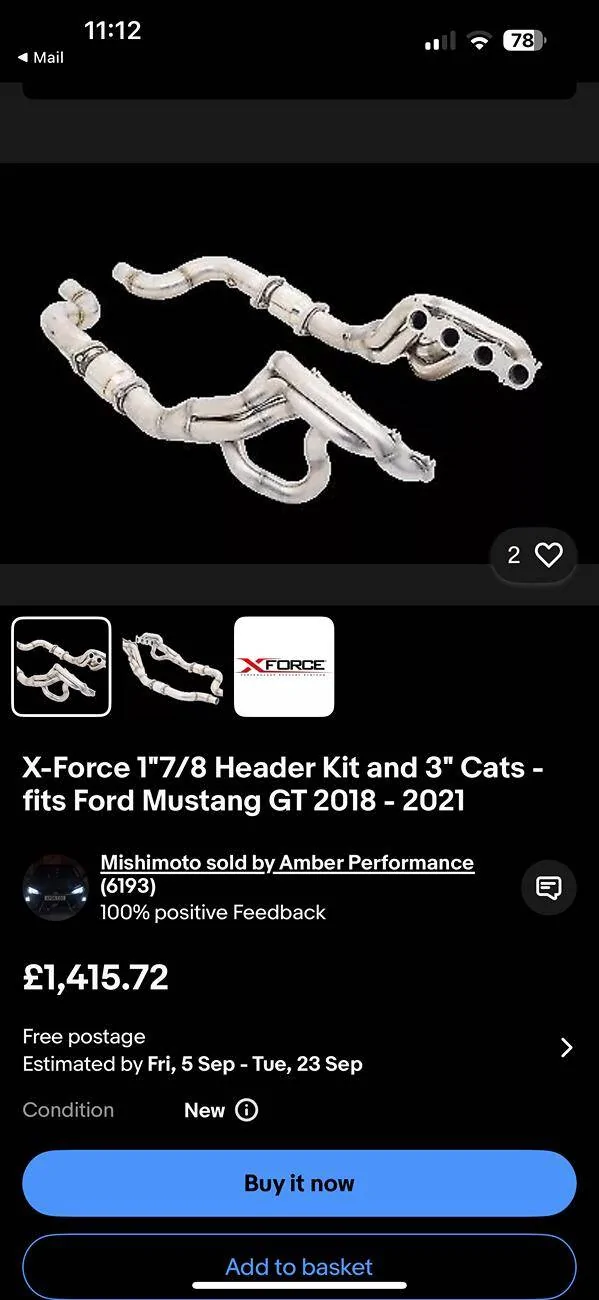

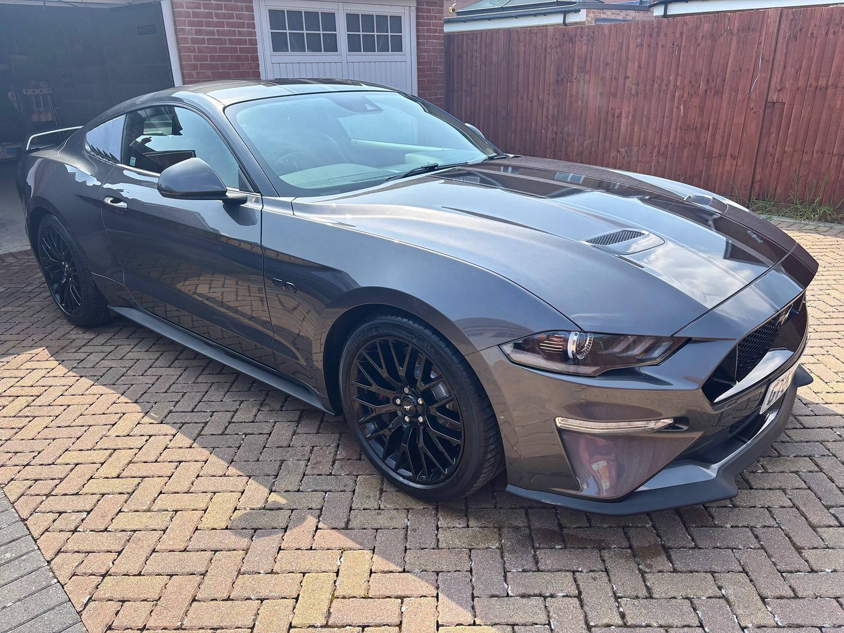

Guys just wanted to know if it’s worth getting headers for the car it’s a 2020 GT rhd UK. Bit of a newbie to the Mustang customisation arena and could use your advice. I’ve seen this off eBay and is it a good deal or worth doing?
Tally
