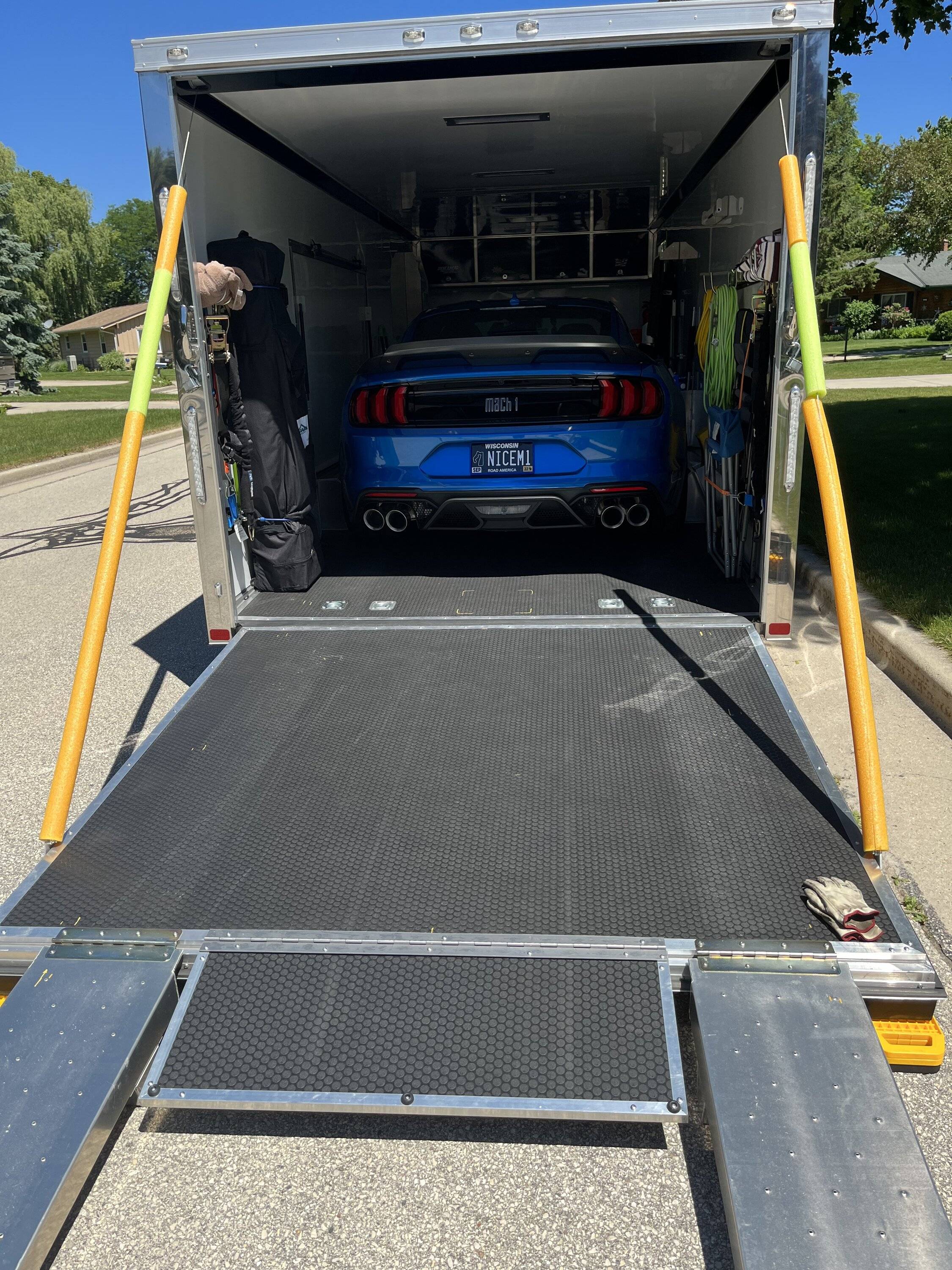

I’ll take some pics once my straps get here to show the floor tie down points. I’m set up to use the factory D rings front and rear. In the rear I had the trailer man put in another set of D rings to secure various loads. There is not E track for the car underneath on the floor. There is E track on the walls in the rear to secure supplies and A track in the front on the walls with a strip of A track in the base of the floor to secure various loads and supplies. Once I get the car situated fore & aft, I’ll put the measurement in a post.

The trailer is a 2018 ATC 24’ CH305 with escape door. It came with the front cabinets both overhead and floor. 50amp circuit box with smart battery charge. I added a 5,800 pound winch with syn rope. I had to use math to figure out the angle of the dangle so the mass meets the ass for the 6 foot PitPal ramps that I installed to get my previous track car in the trailer as that only had 3 & 1/8” ground clearance. I have a F350 diesel SRW to haul it around.

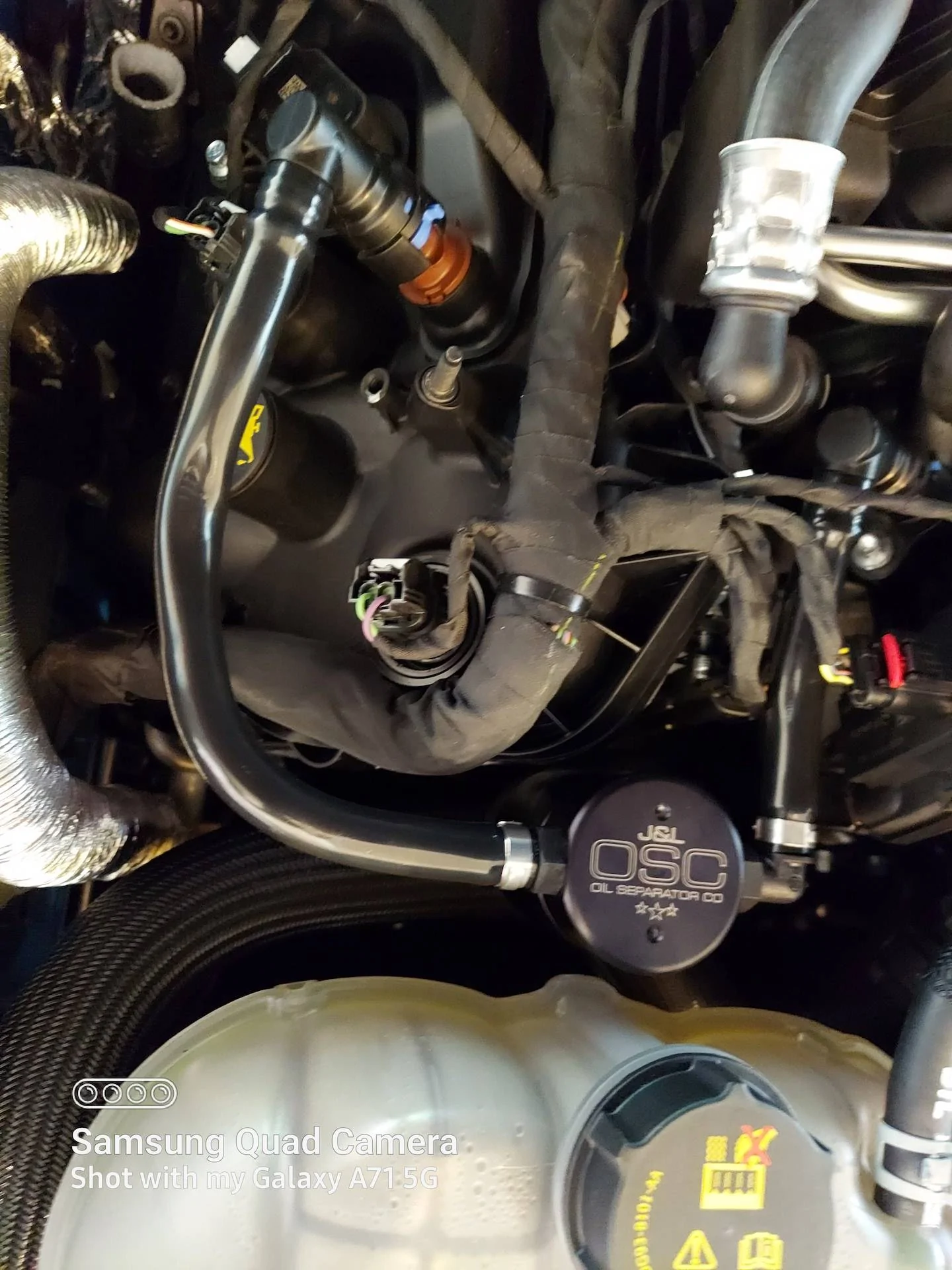

Last night I also installed and oil separator, from J&L. Takes only moments to install, but...it does take some finessing. See the right side of the photo, where it snakes its way in-between some wiring. I probably took it on and off 10 times, bending this and adjusting that, until I got just the right shape and position. Now, it rests just right.
It helps to be relaxed and take your time. The type of clips used on any new car can break easy. I temporarily removed some wiring connectors, to see how to best route things. Best done on a cool engine in the garage.
As people have joked about saving the sound tubes everyone rips off (I need to do that to), save any bits removed. Years from now, you just never know.
I don't think Mach 1's have a sound tube.
Yeah, Mach 1's do not have a sound tube thankfully. I didn't enjoy ripping it out and plugging the firewall in my 2017 GT.
Cool. I hadn't started looking for it. You saved me a lot of time, Thanks. I dunno how long I would have searched for a sound tube that wasn't there. :headbang: Trust me, I would have kept looking. LOL.
