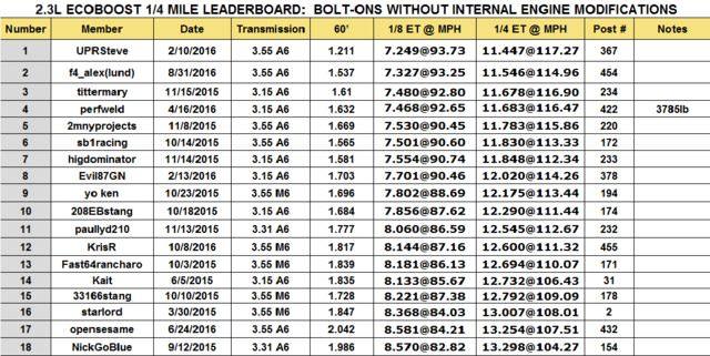

IMO, that seems too slow, especially when compared to other EB Manual transmission times.
I don't know what tires these people are running, but here are forum member times from this thread:
My weight was 3825 too.
I datalogged with the tuner and all was well.
Car doesn't feel slow, so idk if its shifting points or what.
