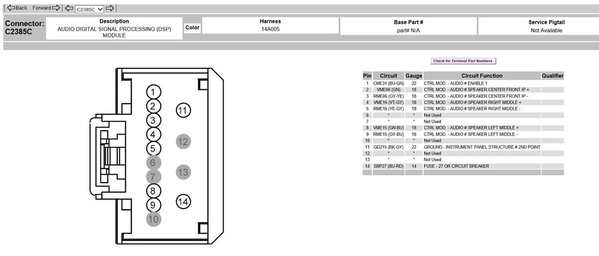

When I unlock the car and open the door the stereo makes 4 quick thump sounds.
16 mustang GT base 6 speaker system
What I have installed is 2 alpine amps. A pdx m12 and pdx f6, 15" idmax d4 woofer, 4 kicker ksc65, and lc2i.
What could I take. A look at to try and fix this ? I didn't do install so I'm not 100% about what is going where
Thanks in advance.
