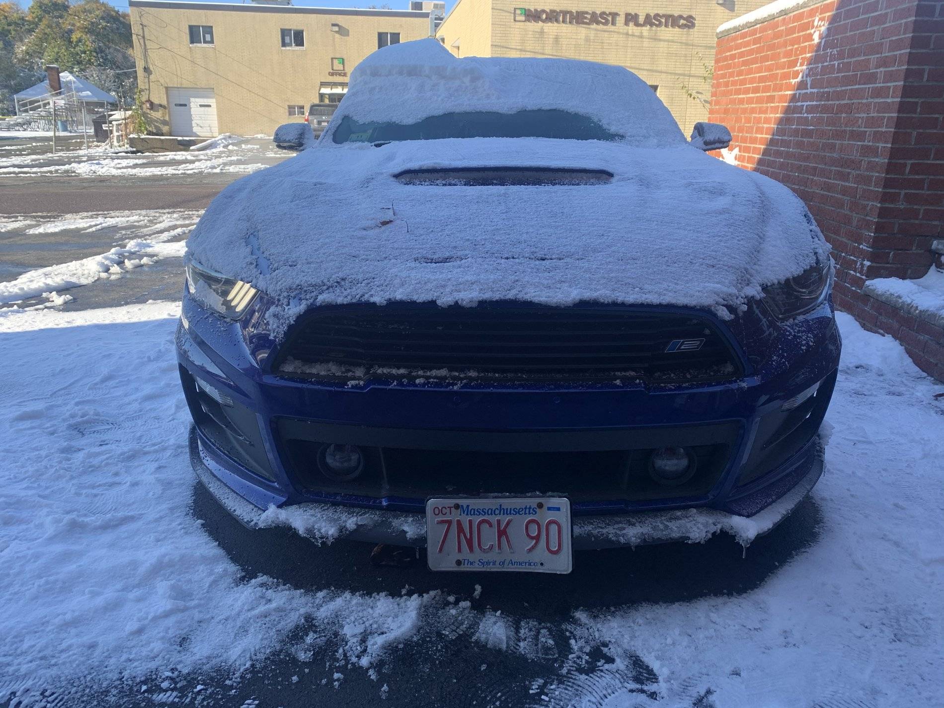

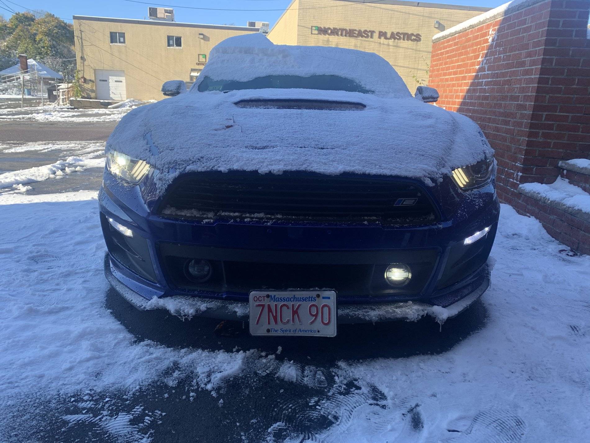

I have a 2015 roush stage 2 (mustang gt premium lol). So ive had weird electrical issues in the past. I lost my brake lights. Ford replaced a BCM under warranty. Also, my passenger window regulator went and that was fixed under warranty as well. Id say both incidents happened around 18 months ago.
A few days ago, it snowed here in boston, so i was cleaning snow off my car and noticed one of my DRLs not working...
when i have the lights on “auto” 1 DRL does not work. When they are in “park” both DRLs work. When i turn on the headlights, everything works except for 1 fog light and one headlight projector beam.
So far ive tried unhooking the battery overnight but that did nothing. I am now just hoping it fixes itself.
I attached a couple pictures of the lights.

Did you ever figure this issue out? I am having an issue with one of my tri bar LED "gills" on the passenger side sometimes flickering and sometimes fine..

Yes. Believe it or not, a Mouse ate the wires..
