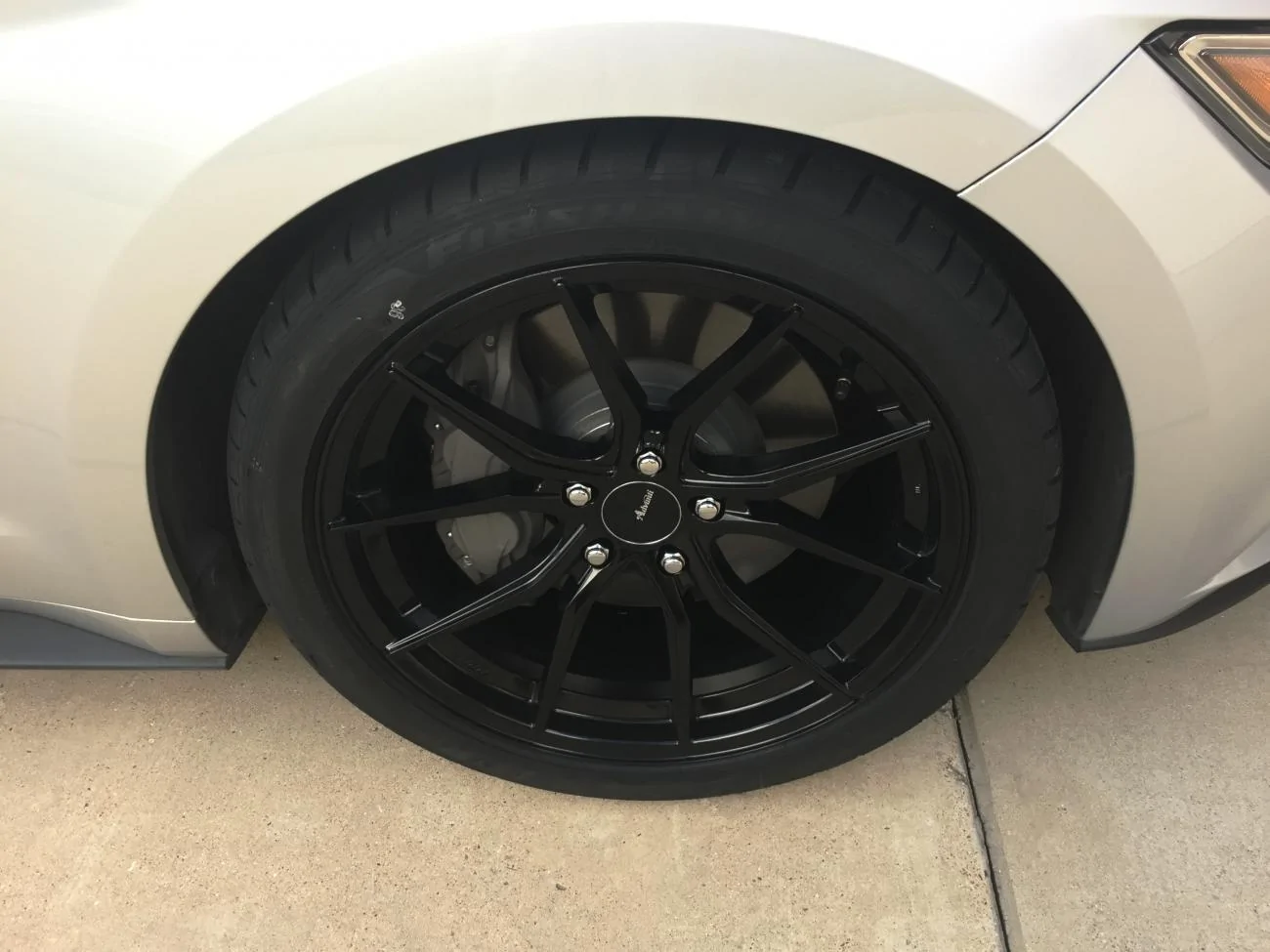

Put a 285/35/19 on the 19x9.5 Advanti HY Hybris. I did and it looks good and performs well.
Isn't it too much a 285 on a 9.5? It looks like that you are starting to lose performance mounting bigger tires without having a wider rim
