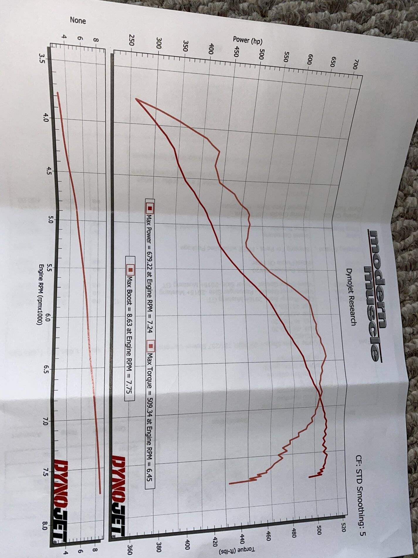

E85, Paxton w/3.6 pulley, lth, sai li fuel system, 1000cc injectors
Jealous! Didnt want to commit to E85 just yet. Throwing some power down man! 💪🏽

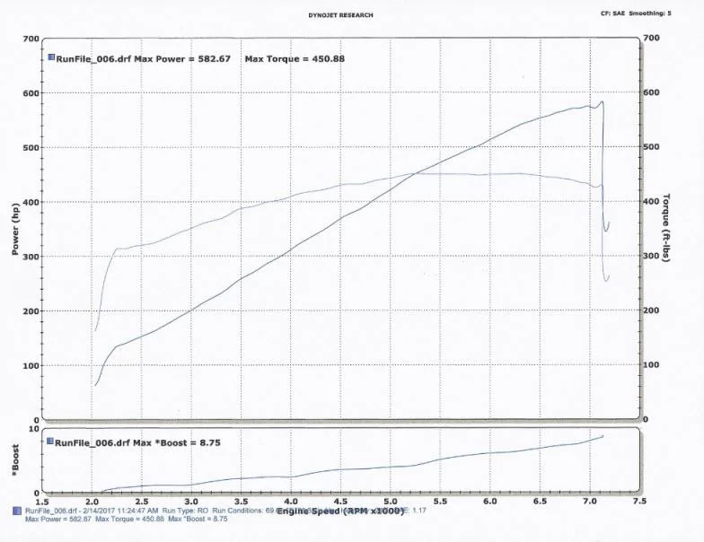

Anyone else get close to this result with the basic Vortech kit with a JLT air cleaner, larger injectors and tune? This was achieved on crappy 91 octane gas here in California.
Would love to know if anyone is getting significantly more power with similar modifications and how you did it. :)
Those are great numbers for that setup and on castrated Cali gas too! 🍻
