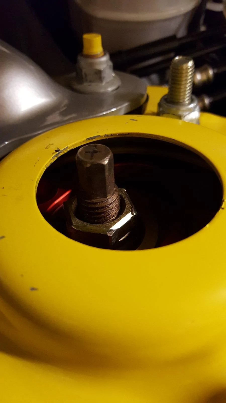

I’m installing their CC plates, and am wondering if someone who has these will be kind enough to count the exposed threads above the top nut. I’ve got 4 threads showing and my impact gun doesn’t want to go further. Am I in the clear?

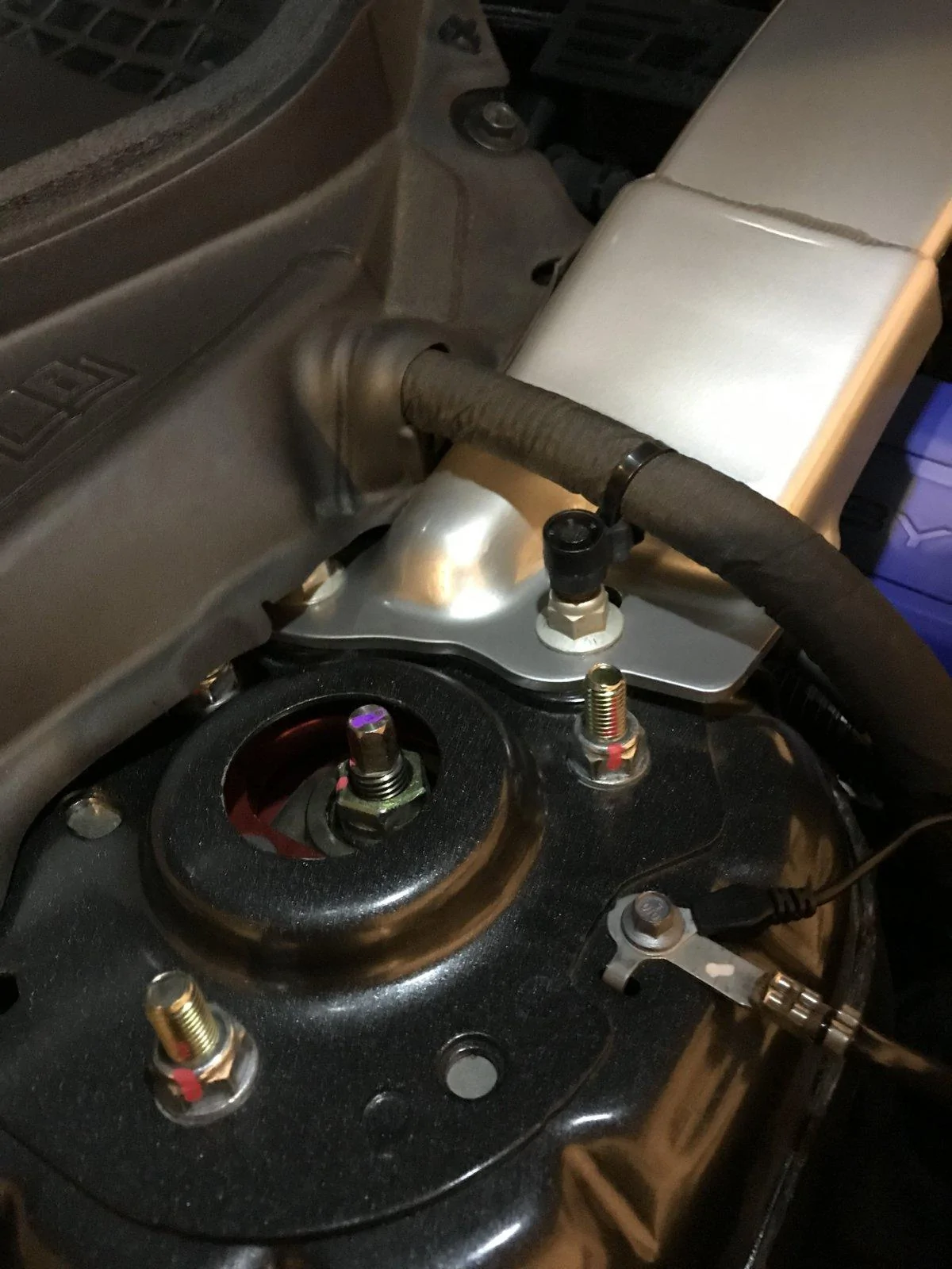

Let me go out into the garage, hold on.
I need to go out there and get the bathroom scale anyway.

4 or so threads is about right. That part of it is really important. If you dont get it honked down with an impact wrench with the spring compressed, it will just loosen down the road.

Hmmm... it looks right compared to yours. I’ll paint a witness mark on it and check after each session. Thanks!

The instructions say to tighten until the sound of the impact gun changes. Even with very short squeezes, the strut rod is spinning now. I never got it to make the “stalling” sound. I’ll measure against the other side tomorrow and see how they compare. You’re right, if it loosens it’ll be a pain.

Same here - see picture.
