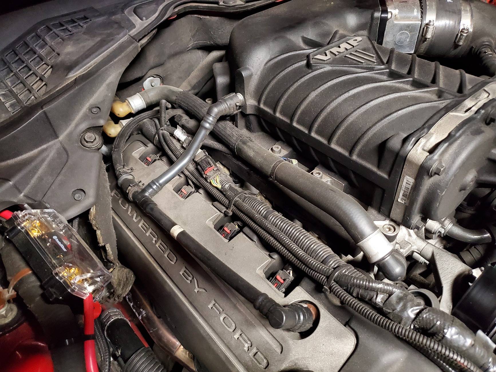

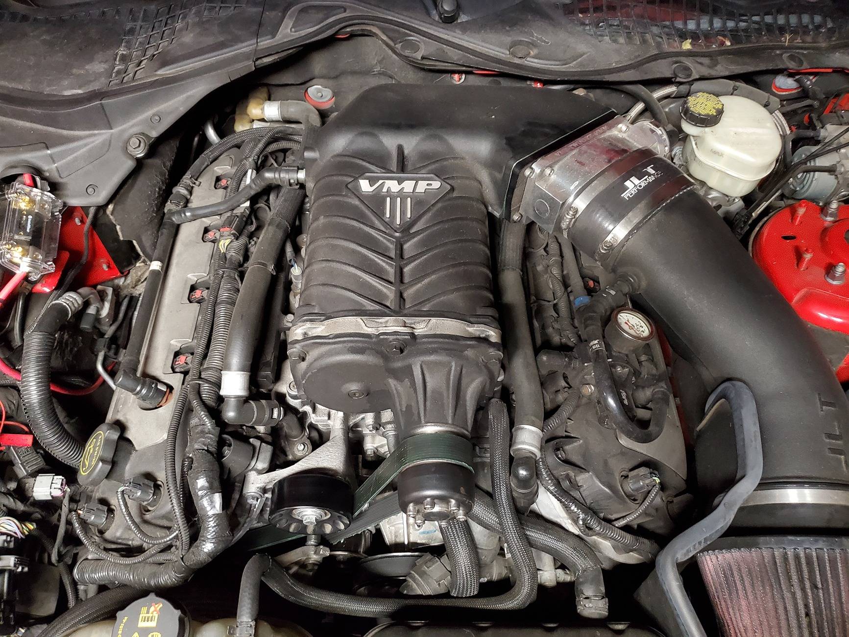

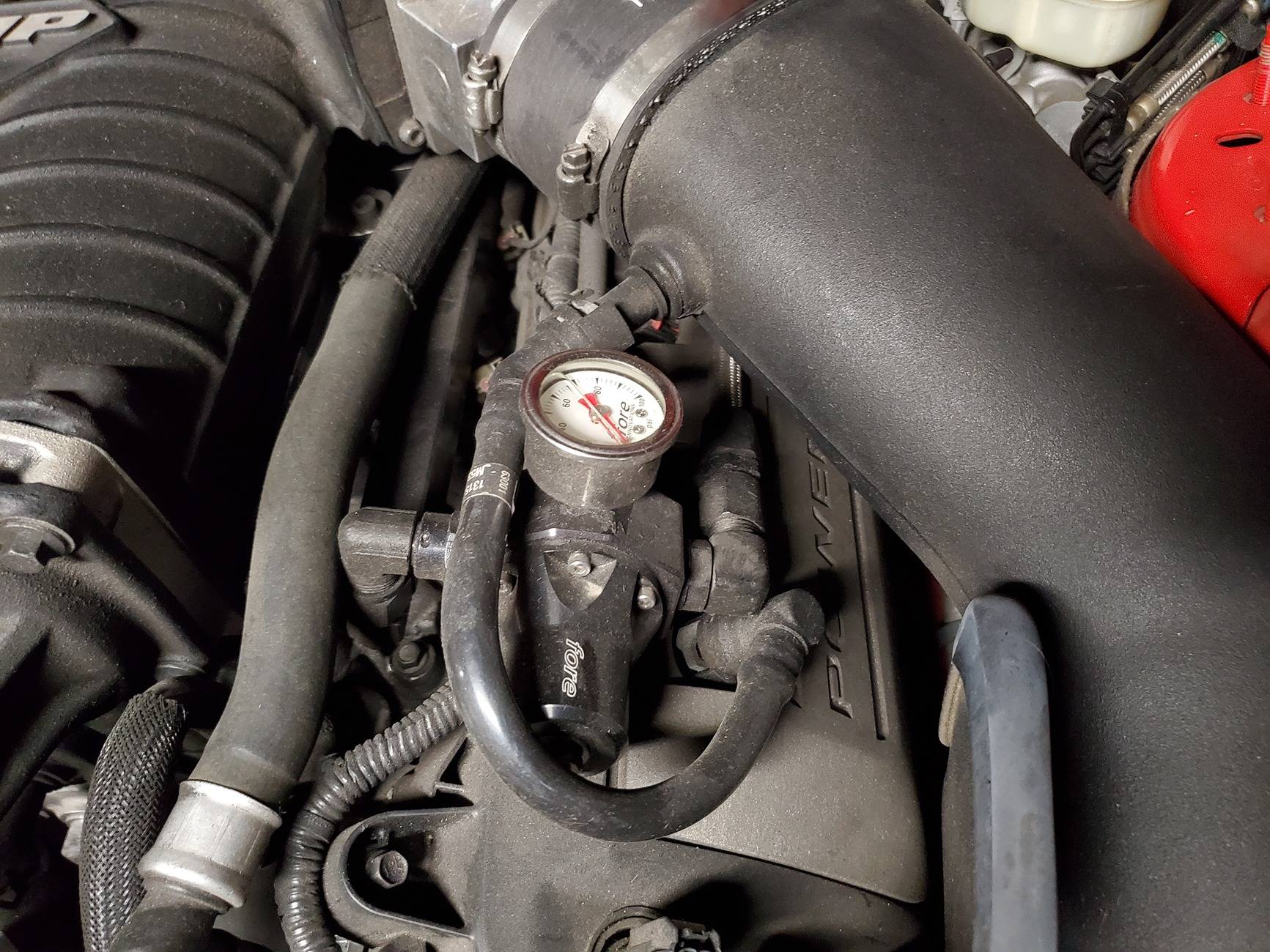

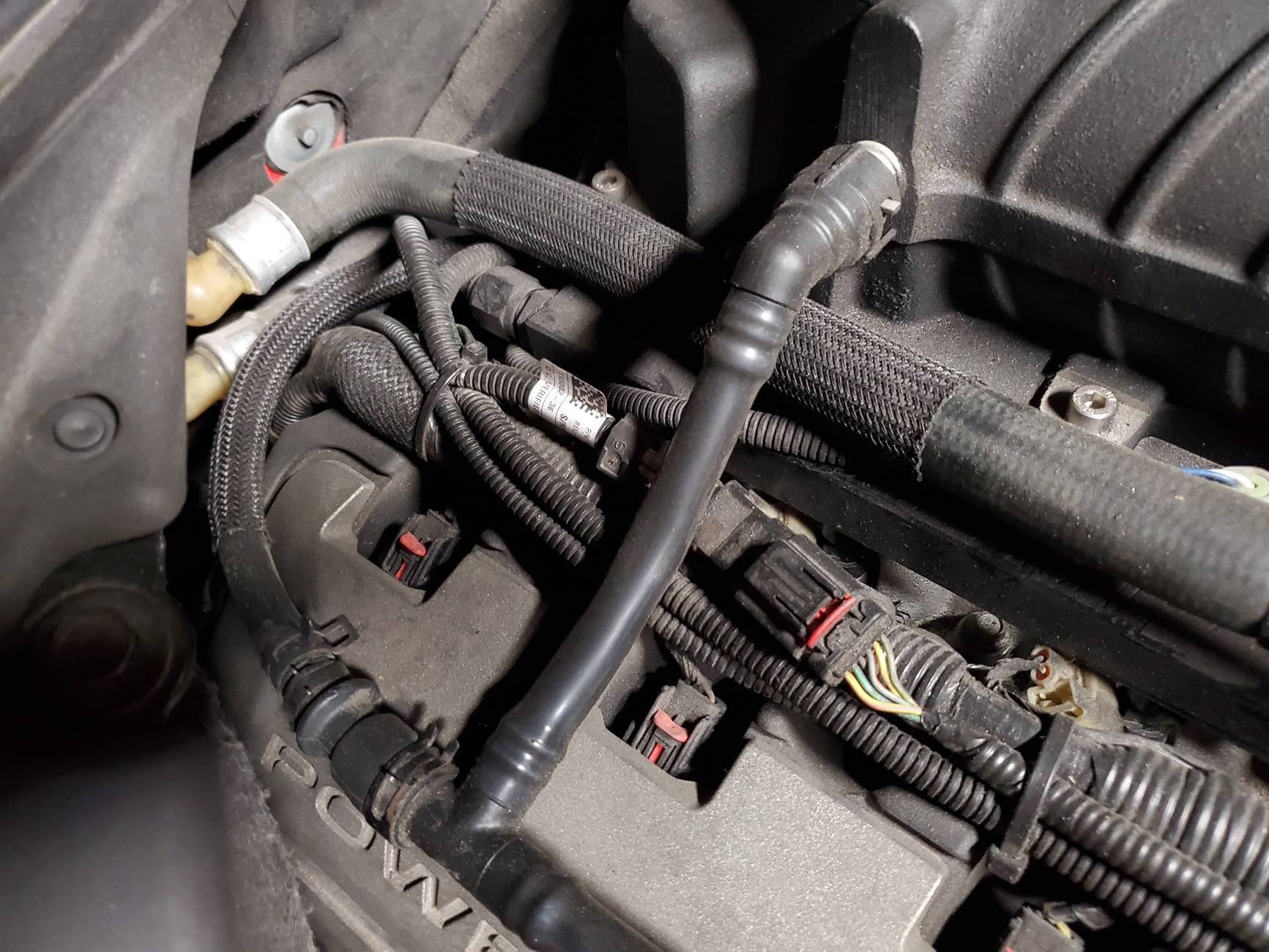

@robvas Here are some engine bay pics. From what I can tell, it all looks pretty stock as far as setup/routing goes.

The moisture buildup happens a lot in winter so maby?
catch cans catch oil blowby and pcv goop. oil reduces octane rating so that's bad but on e85 no care about that so the next thing it does is prevent intake valve carbon buildup on direct injection cars. gen 3 motors are di pi blend but the pi cleans the valves so no need there.
I don't have a catch can and I'm not really wanting one tbh. u need a small can to fit it in any spot that you can drain easy in this car and u need 2 not to mention if u forget to fully close one u have a vacume leak lol.
You don't need 2. Just the passenger side. The driver's side is almost universally bone dry and not necessary/required.
And just because someone is running E85, doesn't negate the interest of NOT contaminating the quality of the air/fuel mixture. MOST of the time, most E85 tunes are on the edge of knock and introducing large hydrocarbons into the mix, especially when the motor is properly loaded (in the real world vs a dyno) is just one more thing to contend with.
I run JLT's on both banks, but really only need the passenger side. I check/empty it about once every few outings and empty an ounce or two of fluid. Simple. Easy. No tools. Just twist it off (with a rag for grip) and hand tighten it back.
