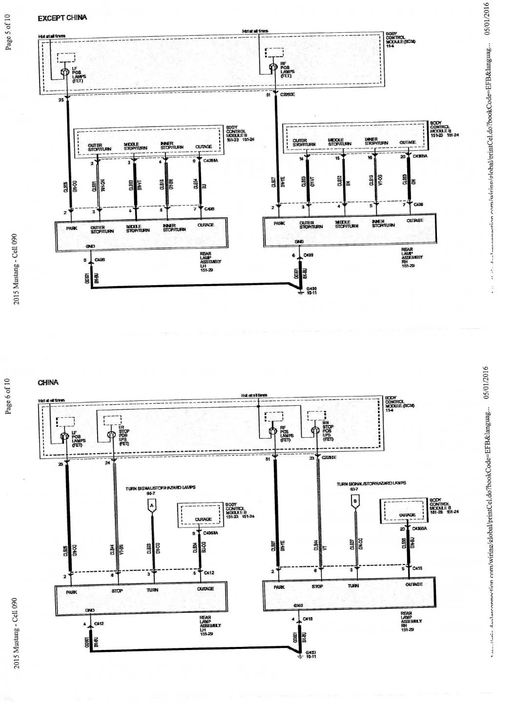

As you can see, the wiring is different for euro version lamps vs usdm.
Thank you Gfswindle.I appreciate your help. Vland are sold as valid for USA and EURO mustangs, and I know wiring is different and as a matter of fact I had to move the wiring pins in the connectors to the right place so turning lights, brake and rear lights work fine with acc on but engine off. Problem is the turning lights don't work when engine is running. Looks like there's not enough amperes, cause I measure the volts and they are the same as when engine is off. Any body got the same problem?

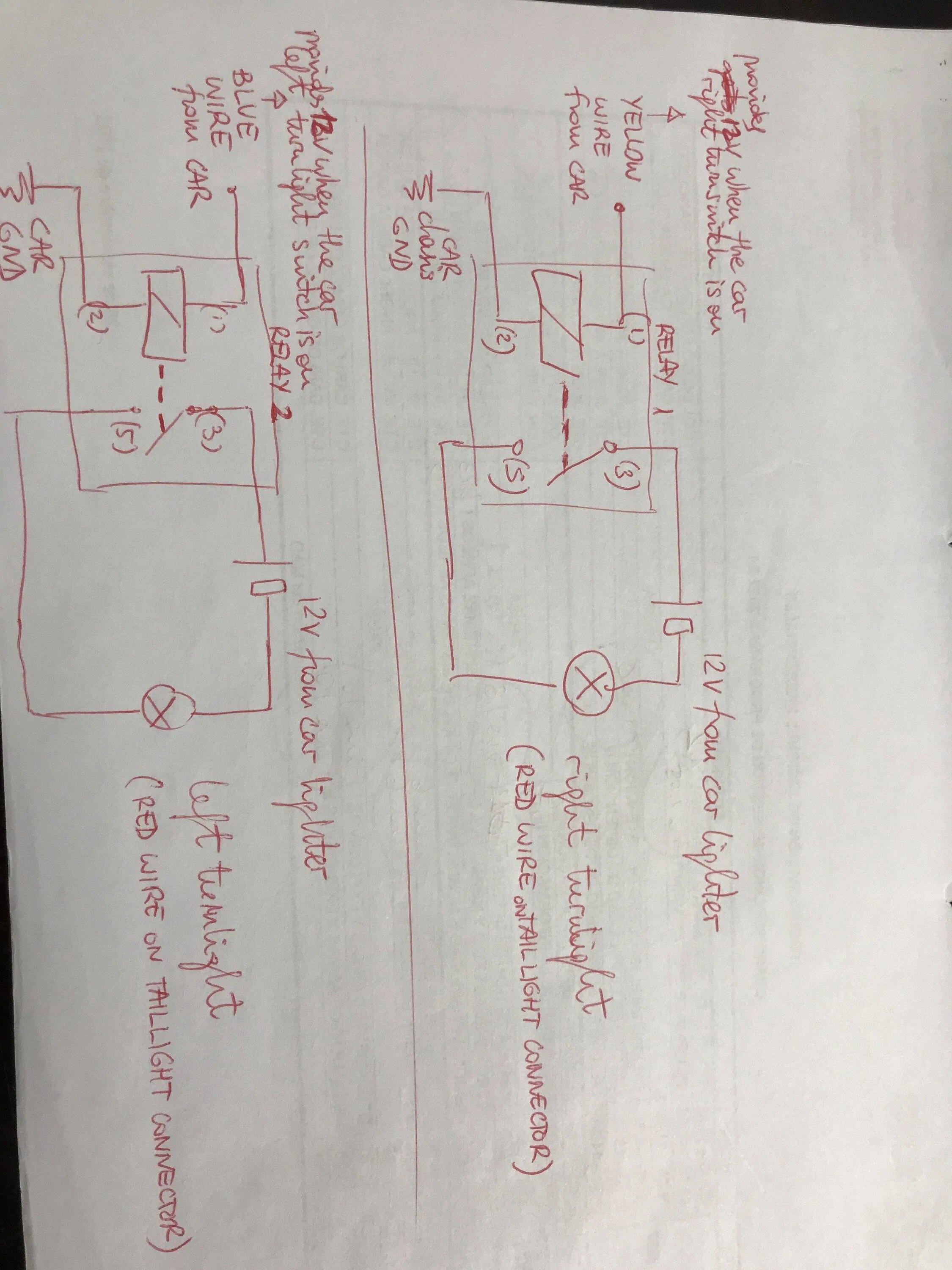

I was frustrated and tired, so tried to get the 12v power from another source. I plugged the red wire from the taillight connector to the 12v from the lighter with the engine on and IT WORKED!!! So it was just to install relays to drive the taillights!!!
Then I connected a 12V 30A relay (RELAY2) so that it is activated when the turnlight switch is ON (12V go through a BLUE wire from the car connector(LEFT TURN LIGHT) closing the output circuit that drives the 12V from the lighter to the red wire in the taillight connector , turning the LEFT turn light on. Doing the same process with another relay(RELAY1) activated by 12V on the YELLOW wire from the car connector that activates the relay when RIGHT TURN LIGHT switch is on, the 12v from the lighter turns the RIGHT taillight on. See the scheme attached. By using this circuit everything works now with engine on, even the 5 modes turn lights.
Hope it helps if someone has the same problem that me. ISSUE FIXED!!!
Best regards guys

2016 GT
Op...let's pretend for a second that I am completely dumb when it comes to electrical. Do you have pix of the corrected setup? Maybe even a dumbed down version of how to do this fix 🤣
