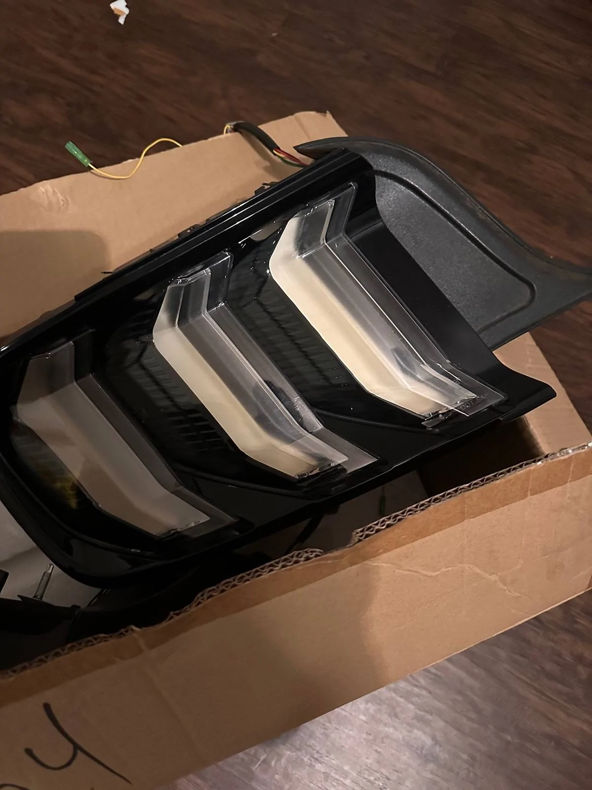

Bought these Vland euros from somebody. The lights work , but the driver side turn signal sequence doesn’t work. It’s just lit up. What could the problem be? Could it be fixed?

How did the stock ones work?

there should be a wire that goes to the roof brake light. you will need that for the sequencing to work.

For the driver side? The passenger side worked without connecting that wire.
yes. Mine connects from the drivers side light. unless you are missing a connection between the two lights.
