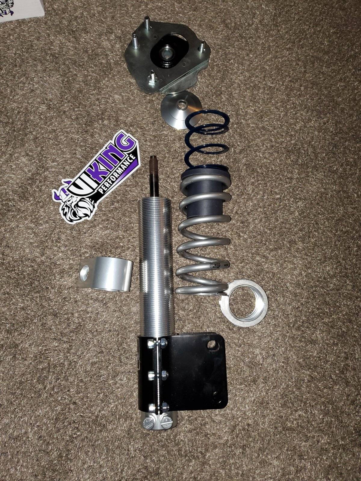

The front struts should have the disclaimer of "some assembly required". I requested they be shipped with 550-lb springs and they sent me 8" long ones with the thought that maybe that spring wouldn't be loose at full droop but no way without a very high ride height. I ordered 7" Hyperco springs and a Hyperco helper with coupler to try.
The Hyperco coupler does not fit over the shock body and even the short end of it it is too long to fully compress the helper before bottoming out against the upper perch. I abandoned that part for an Eibach Spacer250, which fits over and between everything nicely.
The 7" long 550-lb spring was too long to get the car low enough and still fit the sway bar end link mount in a good spot so I ordered a 6" long spring.

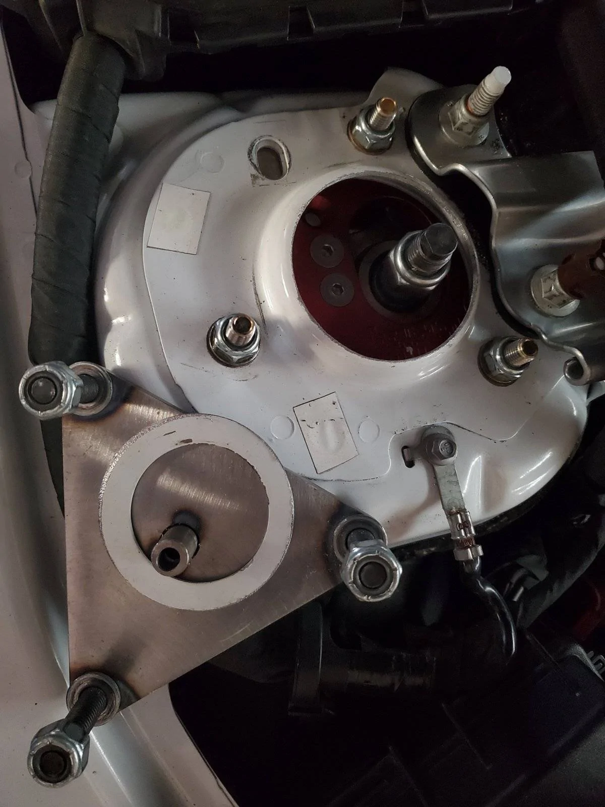

The J&M Viking camber plate in the pic above would work fine for someone who doesn't want to open up the strut tower hole and only needs around -2ish degrees of camber. It appears to be designed to fit the Viking strut shaft within an unmodified strut tower opening. This isn't going to work for me as I want way over -3 deg camber so, I looked into how can I make my existing Vorshlag camber plates work.
Some notes about dimensions:
- uses 2.5" race springs
- does not come with bumpstops
- strut shaft is 7/8" so look for bumpstops that fit over that. I modified OEM ones to fit inside 2.5" springs (slimmed the wide part at the top)
- strut upper mounting shaft is 5/8" and pretty long.
- knuckle bracket is offset ~3/4" compared to OEM style struts which ss great for tire clearance but really mucks up the ability to use adjustable sway bars and interferes with brake lines depending on where the end-link mount is installed.
- fully threaded shock body, even with the knuckle bracket so stuff can be moved around as needed.

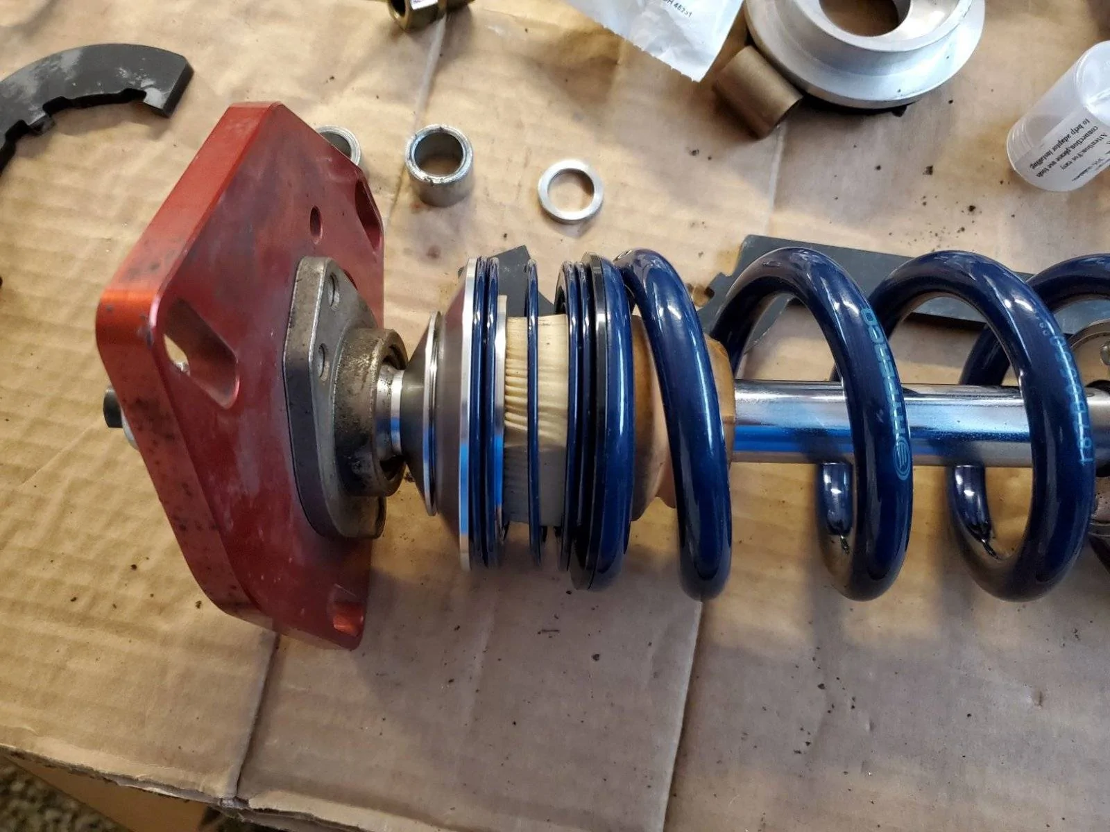

I was able to fit the Vorshlag camber plate on the strut using the Viking upper spring perch and a 5/8 ID x 3/4 OD stainless sleeve I found on Amazon plus some spacers from the Viking and J&M installation kits.
I opened up the strut hole and can get all the cambers now...
