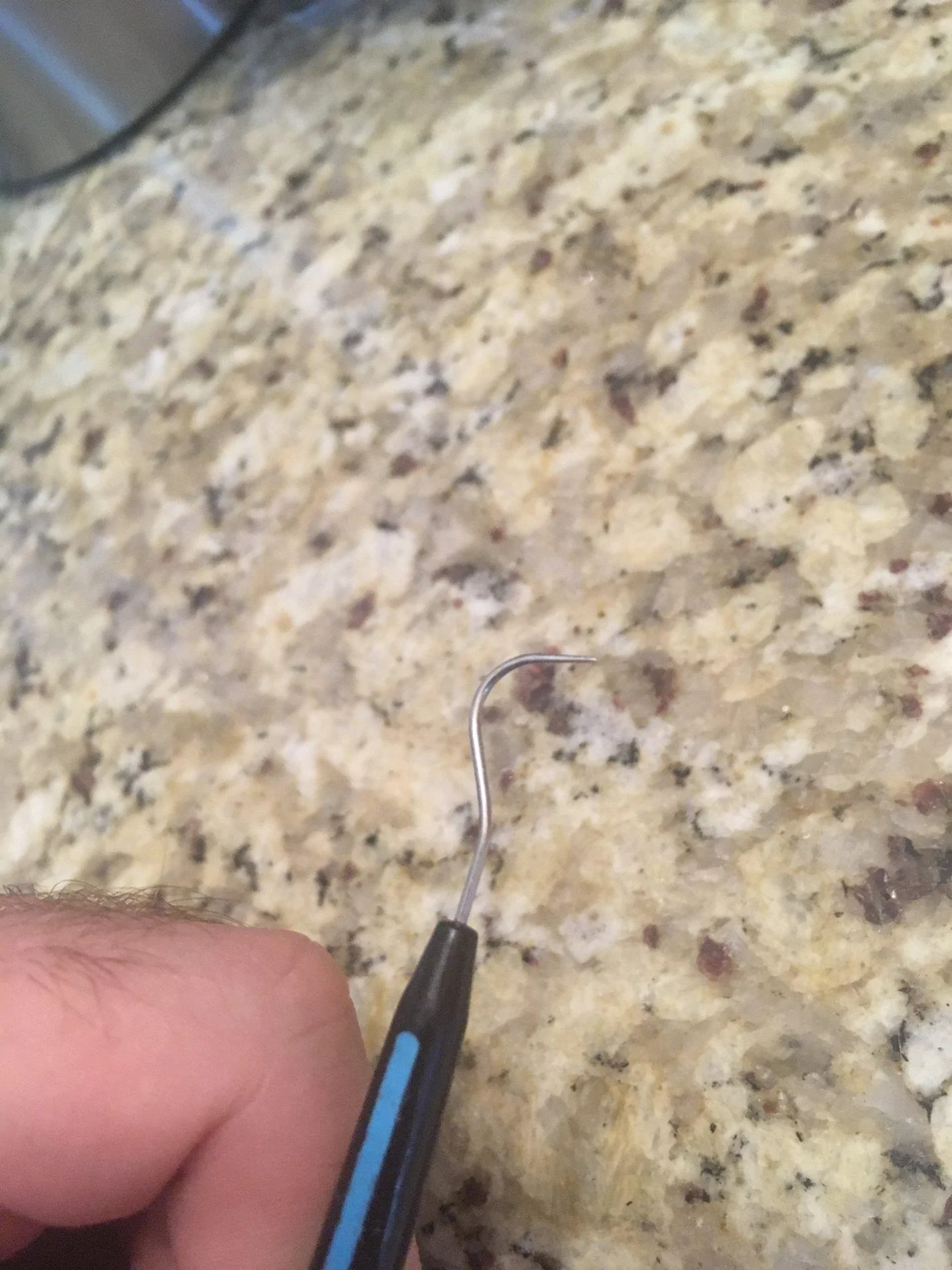

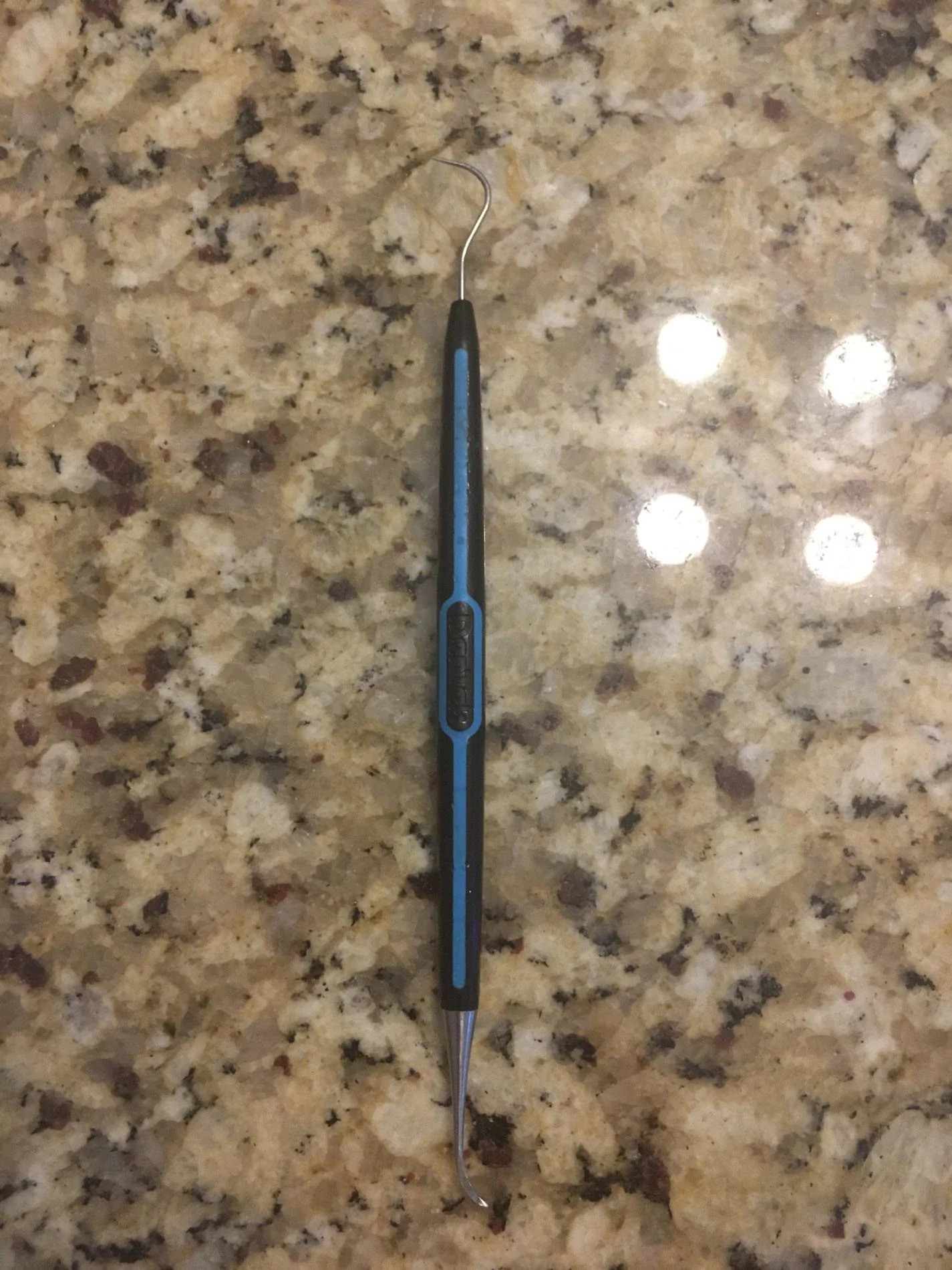

If you do use the paint pen. I agree w the advice except I bought a little tooth cleaning kit for 5 bucks. Has the pick looking things for teeth plaque.
One of them I use for touch ups is this. It’s way finerrrr than an toothpick. I just take small amounts and insert in hole and move tip around filling whole crease, repeat after dries to layer the paint to desire depth, but lower than surrounding paint. I just do one coat myself as long as matches
Then I fill the remainder w clear to level up to the surrounding surface. Just make sure the paint is 100% dry before putting clear.
