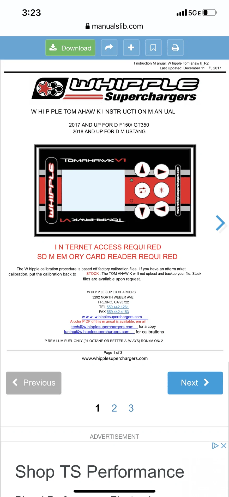

With Whipple’s program hooked up and calibration file selected and open is there a restore option?
Looks like the same flash software as Ford’s Procal which combines the factory and aftermarket tune in a single PC3 file. Restore loads the stock tune. Hopefully that is the case.
Just saw this ;)
https://www.mustang6g.com/forums/threads/whipple-flare-how-to-return-to-stock-tune-help.68739/

The 2018+ GTs use the Tomahawk programming tool. It does not read and store the stock tune...
Rob

Stock files available upon request!

OK, I'll give that a try. I seem to remember that Whipple was not providing those for the 2018+. We will see....

It does not save the stock tune. You would have to go to the dealer and pay to have them load it.
