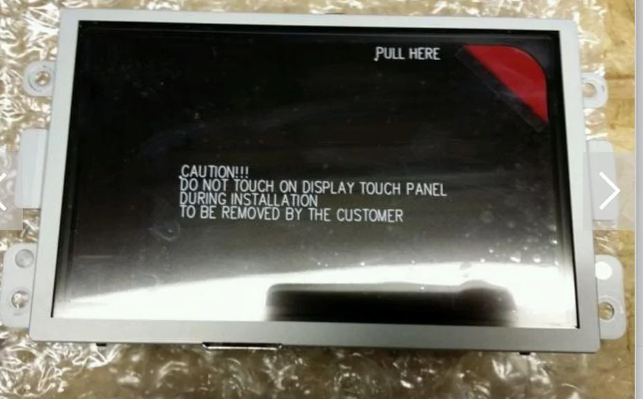

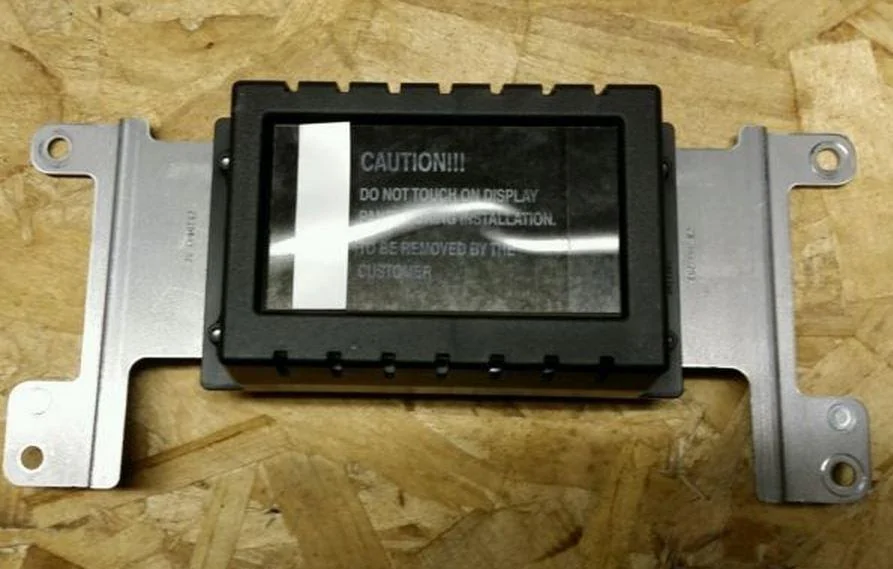

There is!! A few wires have to be swapped in the connector to get it working but the MFT screen does work in base models!!! Myself and aggieStang are working on completing the install. AggieStang is using a premium bezel while I am modifying the base bezel to accept the screen. As long as my bezel works this looks to be a rather inexpensive mod for what you get.
More info and updates in this thread starting at page 21: http://www.mustang6g.com/forums/showthread.php?t=17935
