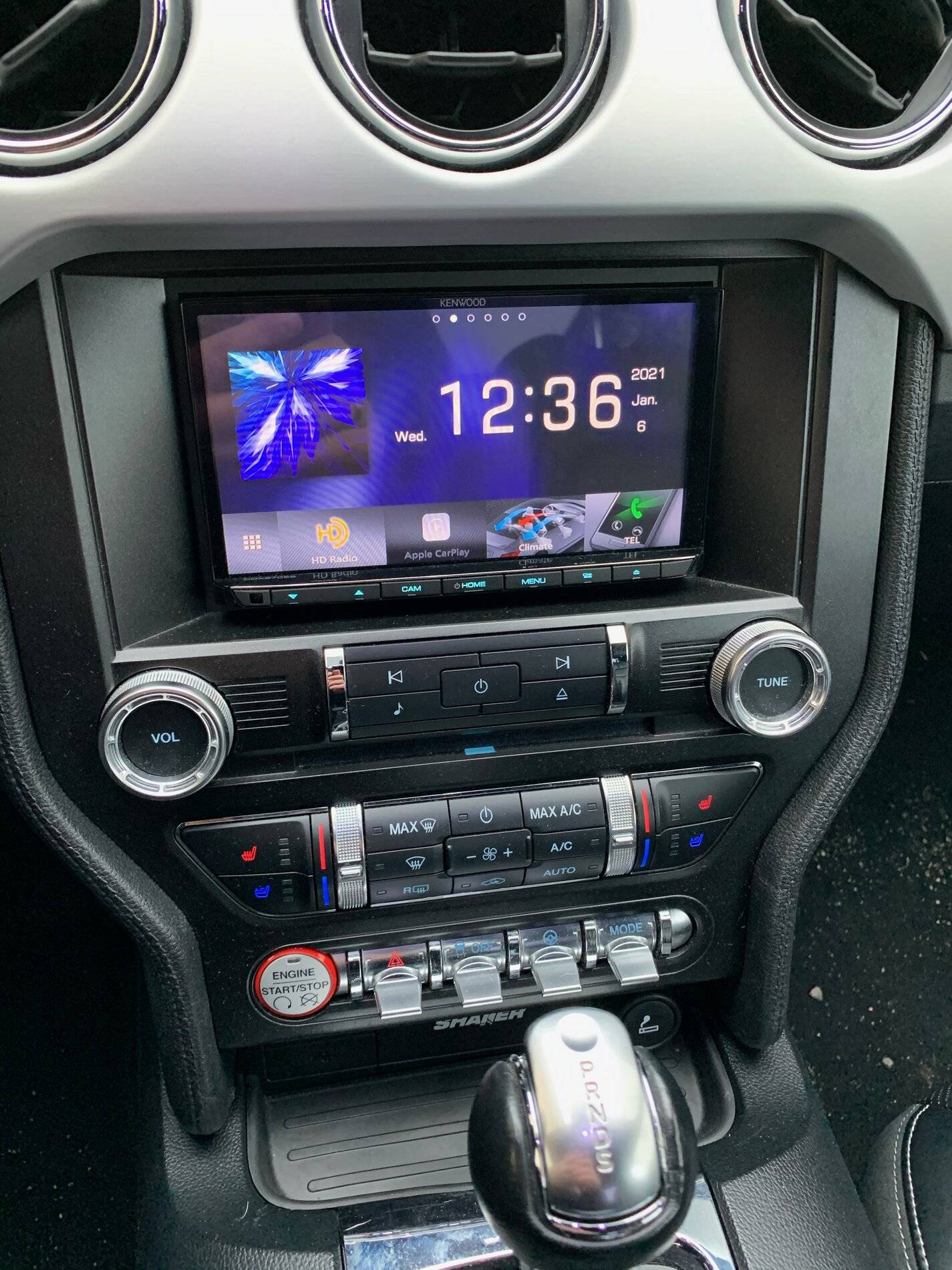

And here's a picture of how a Kenwood DDX9705s looks in the dash with the MFT1 kit.
You can clearly see all the stock buttons, knobs and stuff. :)
(And yes, i know my car is dirty as hell right now. Damn winter!)

Ah cool! Looks basically stock! Yeah of course it maintains stocks knobs.... I'm still used to my old car where it didnt...
That looks killer!
Did you do the install yourself?
