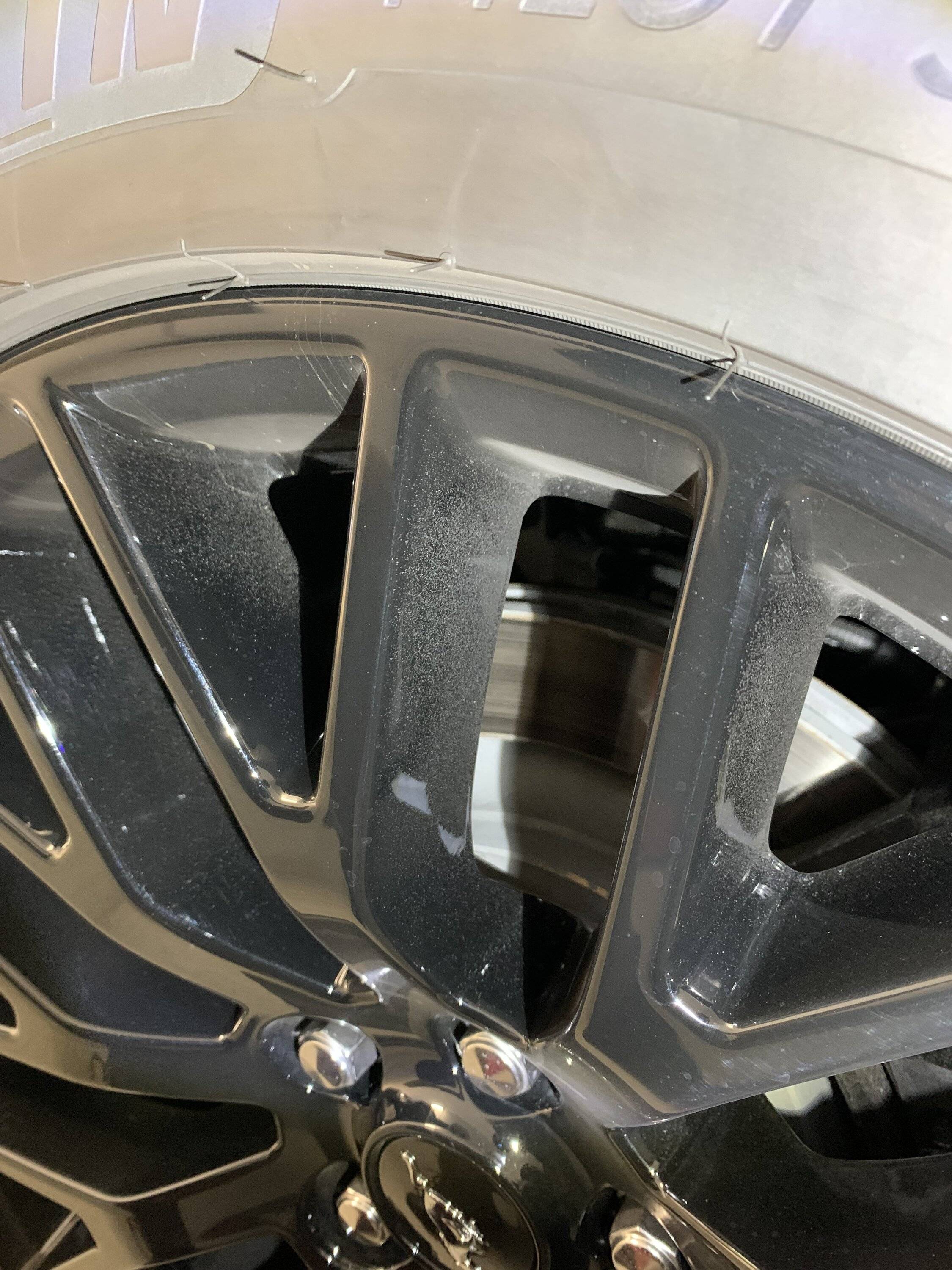

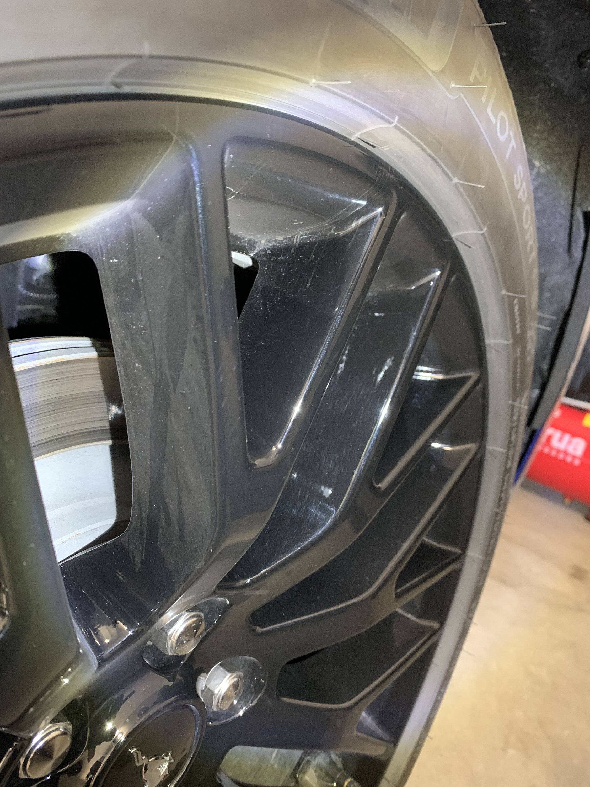

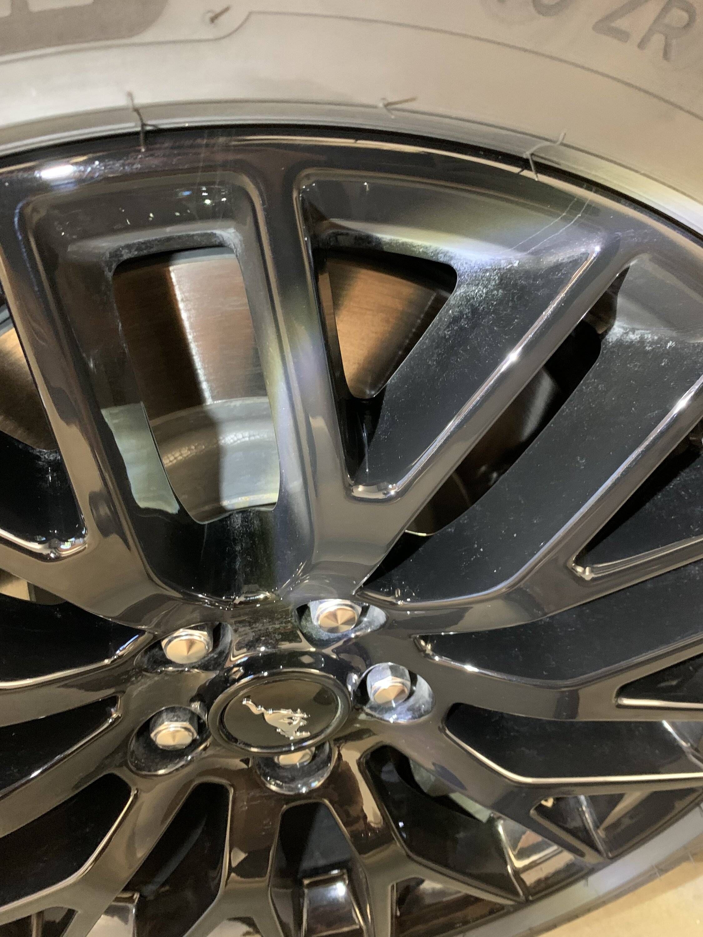

Hello everybody,
after cleaning my new EU version s550 I noticed there are generous amounts of underbody sealant on the wheels, as per the attached pictures.
A normal clean with neutral shampoo does nothing to it.
How can I get rid of this without damaging the paint of the wheels?
I can and will remove the wheels from the car.
Thanks,
Luca

If you can't get it off, having them painted by a wheel repair shop may be the best bet.. Try 100 percent isopropyl.
I made a test yesterday evening on a little piece and tar remover does away with it.
Now I just have to remove the 4 wheels, clean them inside out with soap and then microfiber the hell out of them with tar remover.
