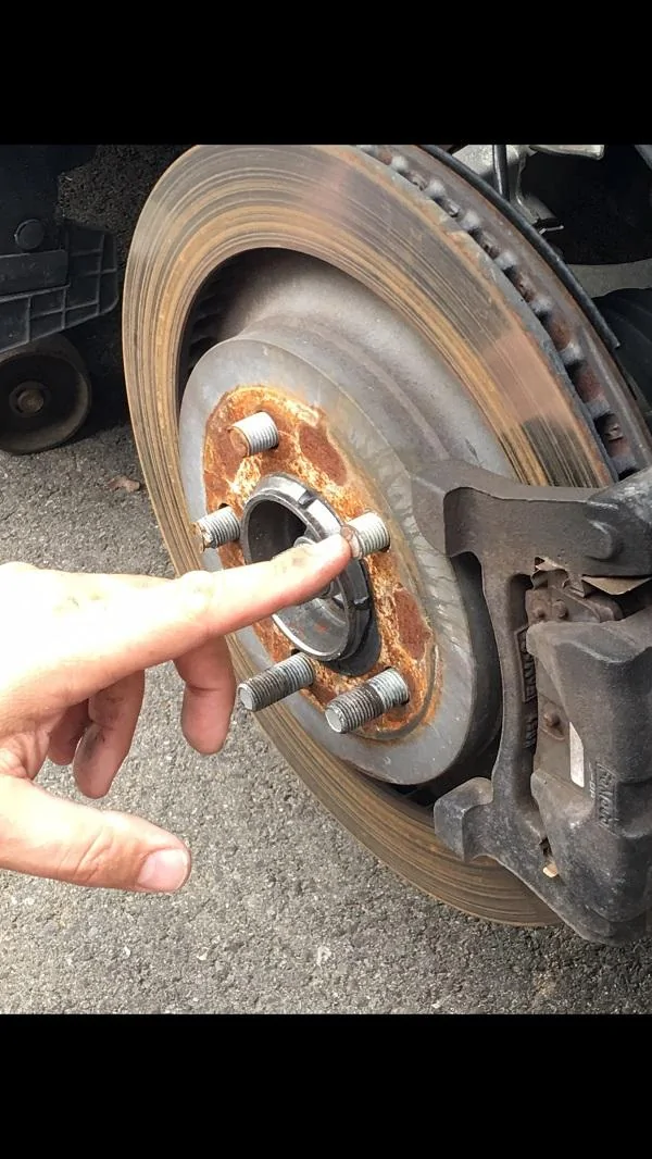

I also looked further at the parts, and I believe the screw on for the lug nuts in the back tire are completely gone...I can't imagine how expensive that's going to be.
I haven't looked specifically at the G6 mustang lug studs, but generally they press in and press out. Sometime the sstumps can be hammered out, or you might need a special tool to press them out. Usually you can press in the new ones by simply tightening on the lug nuts. The lug studs are cheap and available at any auto parts store.
If the studs broke off, be sure to inspect the wheel. Many times (especially with aluminum wheels) the lug holes get wallowed out when driving loose. If they are wallowed out, you'll likely need a new rim.

So, I went to Ford today to see if they could repair my lug nut heads that are completely ripped off. Ford was stomped and they said they would call me.
Eventually they did and stated that when we put the winter wheels on, we removed the plastic pieces and never put them back on. So, the cost is going to be $497 dollars to repair everything (labor included).
1. When we did the winter wheels, no plastic rings were included nor were on my car.
2. Is this a rip off? It feels like it.
3. Who do I talk to if it is!?
Thoughts?
Based on your new thread quoted above, this doesn't look like anyone tampering at all. This looks like broken wheel studs...possibly due to being over-torqued at some point or the nut being seized and then hammered off with an impact gun. The rust on the stud ends indicates that this didn't just happen a week ago either.

In case the OP doesn't get around to it: Mystery solved in another thread.
The plastic hub-centric rings from his winter wheels were left on the hub when the factory wheels were reinstalled. That broke while tightening the lugs leaving the wheel able to move under load which resulted in three studs breaking off over time and taking the lug nuts with them.
The OP left plastic hub-centric rings from his winter wheels in the hub when the factory wheels were reinstalled. That broke while tightening the lugs leaving the wheel able to move under load which resulted in three studs breaking off over time and taking the lug nuts with them.
The ultimate cause was the wheel never fully seated against the mounting surface because the centering ring was "in the way".
I'm pretty sure that Mustangs wheels are "lug centric" as described in this TireRack article. I've run my 15 many thousands of miles on aftermarket wheels without centering rings with no balance issues or lug nut loosening. However I'm always careful to make sure the wheels are properly seated and to use the "star pattern" torquing sequence with the wheels unloaded prior to putting enough weight on the wheel to be able to reach the final torque of 150 lb-ft. Note that the friction between the mounting surfaces is what keeps the wheel from rotating and breaking studs due to acceleration or braking forces. The centering during installation is provided by the tapered seats of the lug nuts.
https://www.tirerack.com/wheels/tech/techpage.jsp?techid=91
The centerbore of a wheel is the machined opening on the back of the wheel that centers the wheel properly on the hub of a vehicle. This hole is machined to exactly match the hub so the wheels are precisely positioned as the lug hardware is torqued down. Keeping the wheel precisely centered on the hub when it is mounted will minimize the chance of a vibration. Some wheels are vehicle model specific and will come from the factory with a bore machined to match that vehicle. Some wheels are designed to fit multiple vehicle models and will use a centering ring system to reduce the bore size to match the hubs of different vehicles. These rings keep the wheel precisely positioned as the lug hardware is torqued down.
Some wheels are non-hub centric by design. These are known as lug centric wheels. With these wheels it is critical to torque the lug hardware with the vehicle on jack stands, off the ground. This allows the nuts or bolts to center the wheel and torque down without the weight of the vehicle pushing them off center.
