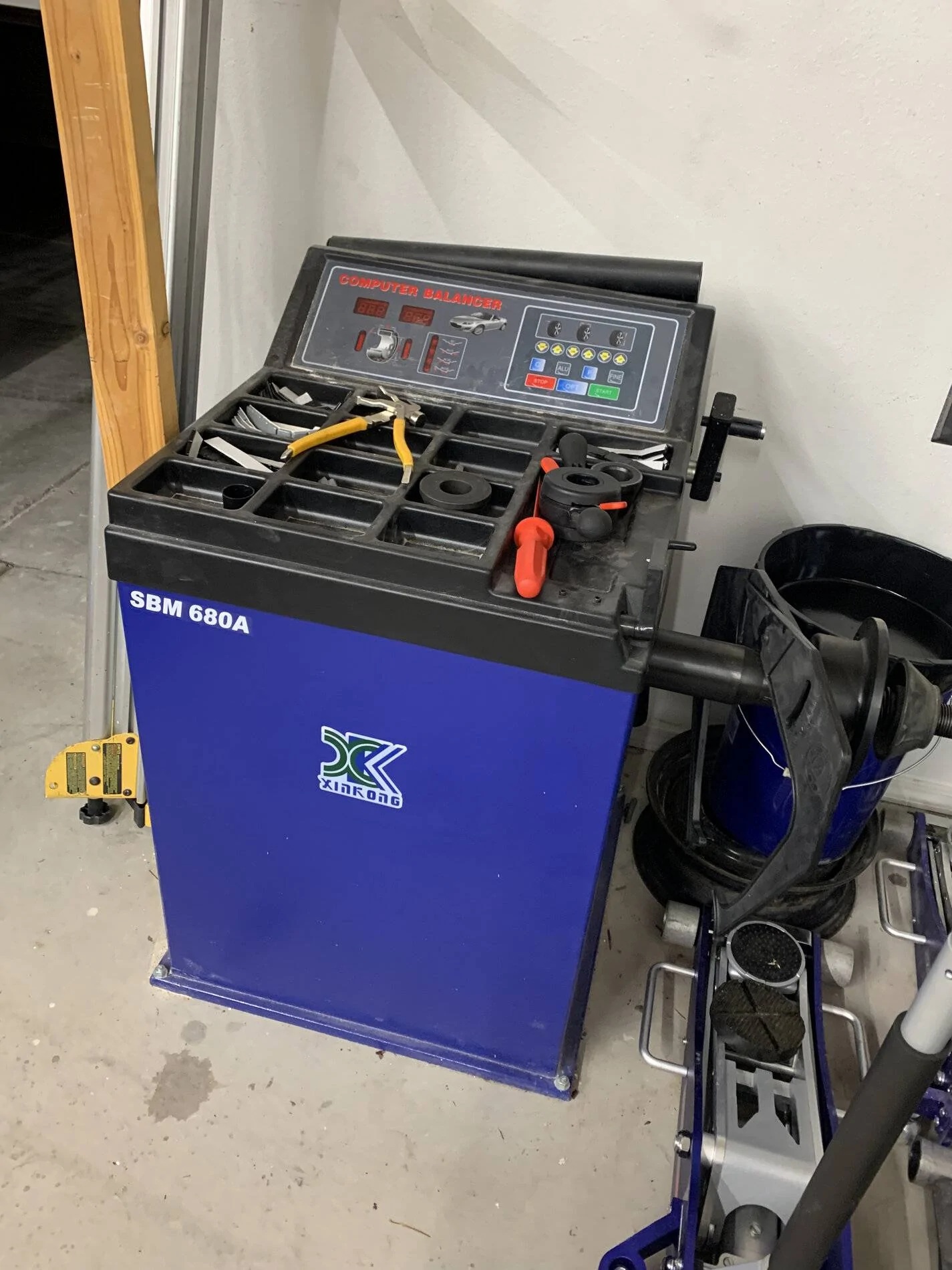

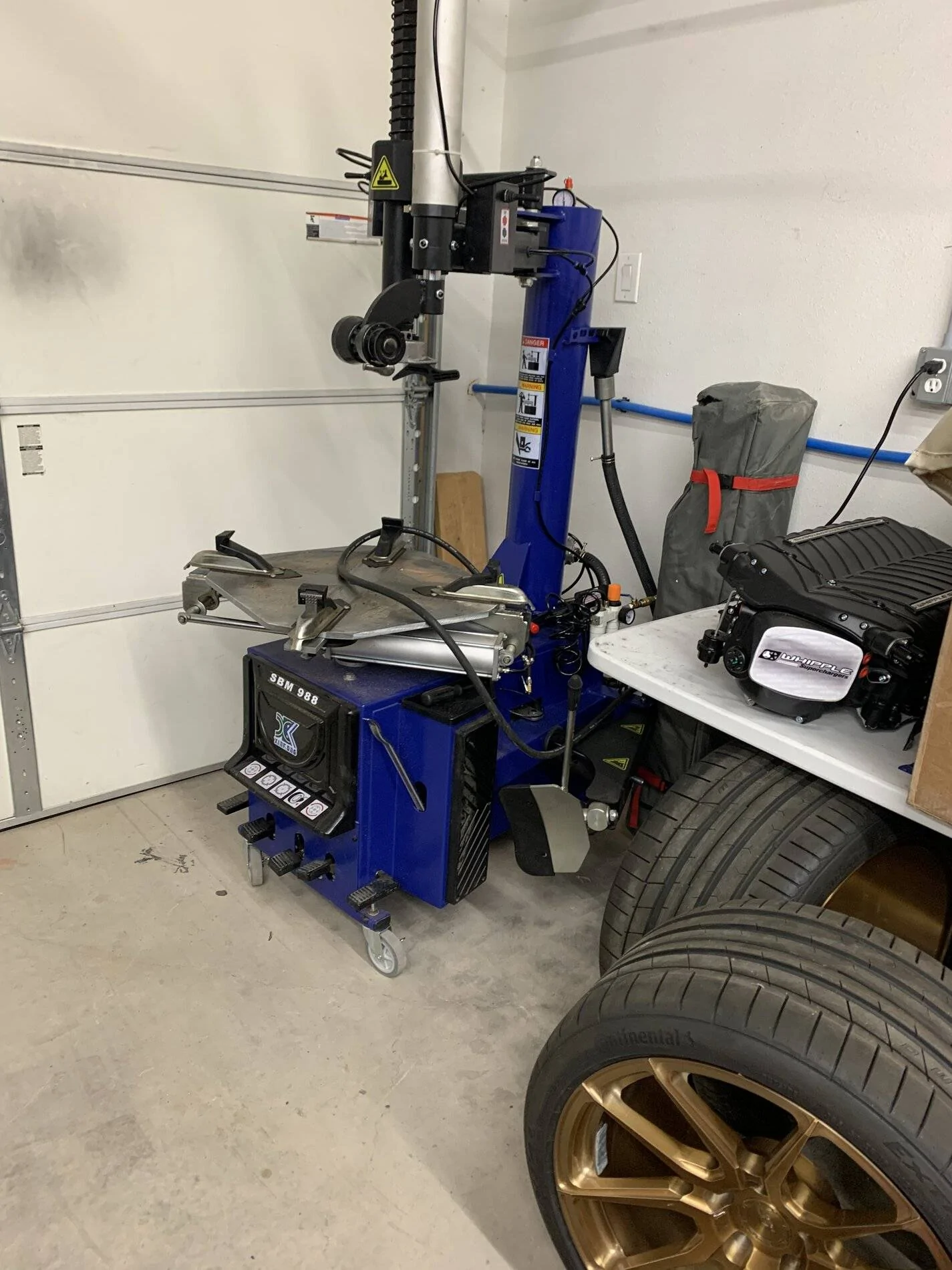

The different heights front and rear matters zero. Simply losing a 1/2 ounce weight will do what your describing. It can be even more pronounced from side to side. They may not of done the balance perfectly to start either. This is one, as is convenience, the main reason I bought a tire machine and balancer.
Added: There is a difference in the adhesive on weights as well. But most often its a poorly prepped surface.
