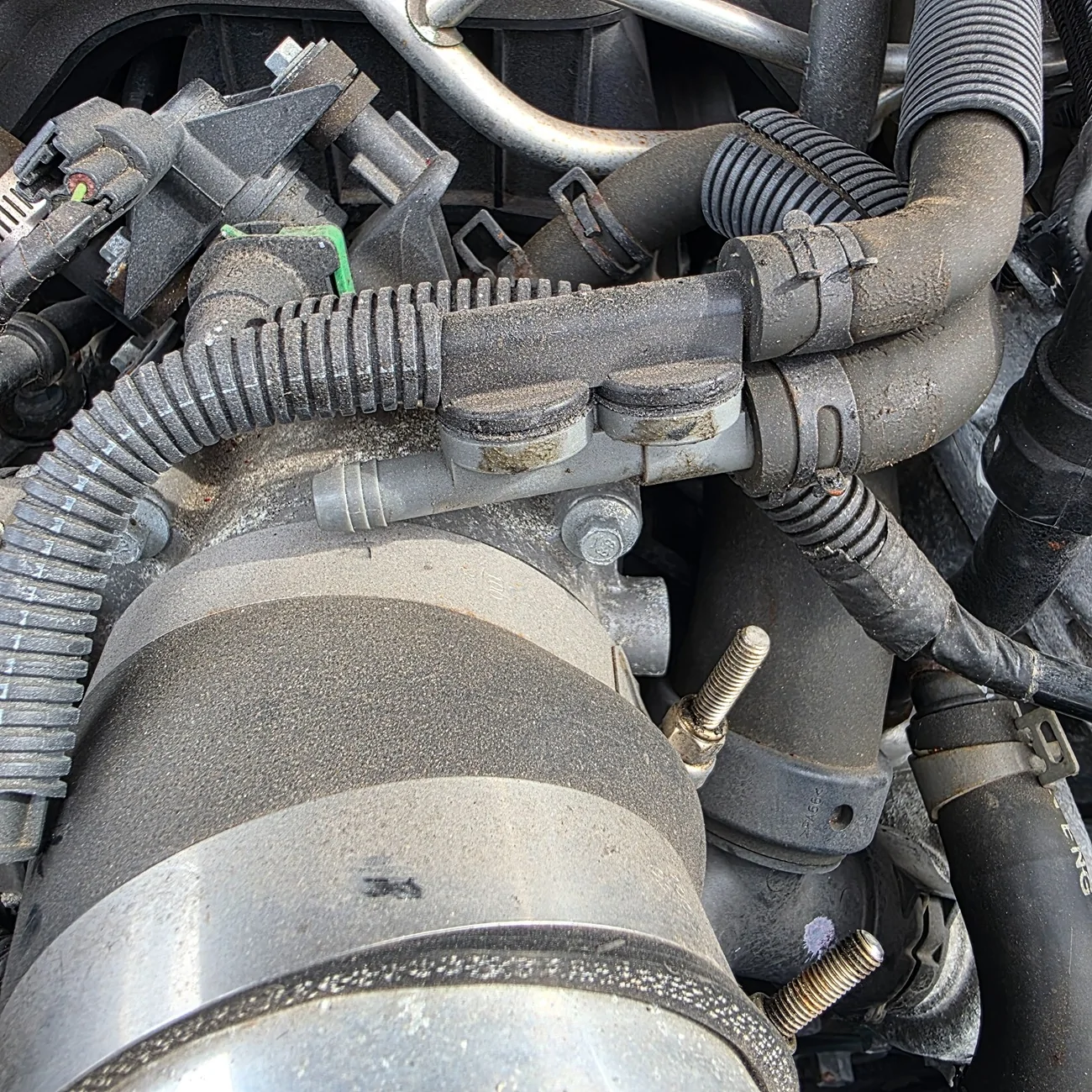

Hey guys,
I have a LPF twin turbo kit, i had it installed a while back and I am missing a vacuum line that was connected to my vacuum block and cant find where this would be connected to.
I checked the waste gates which are Tee'd together and up to the block, intake manifold line and the BOV also is lined in. The only missing line looks like the purge valve (not sure if thats what it is) barbed end. Looking back on some install pics from another member they capped this off.
Any insight would be great.

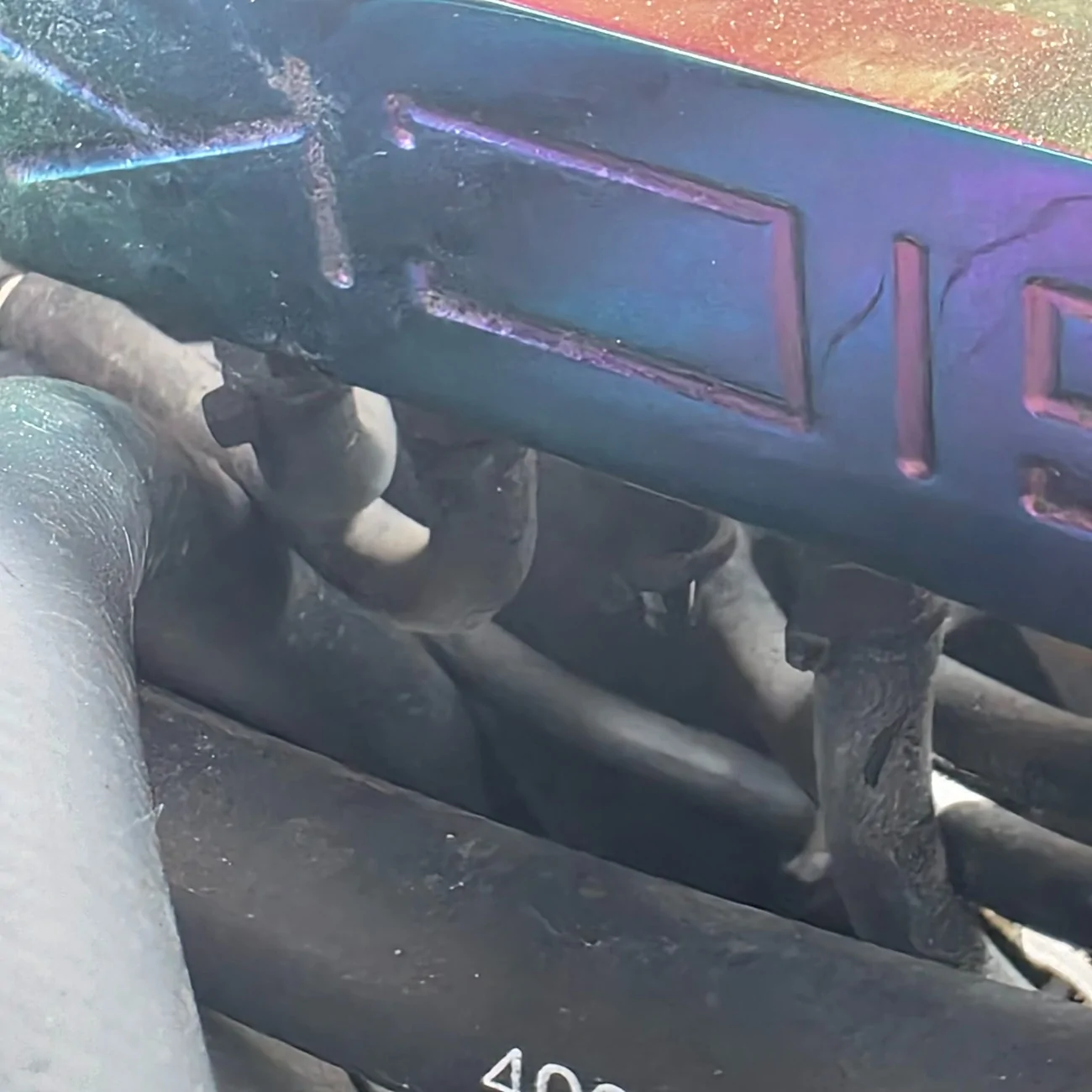

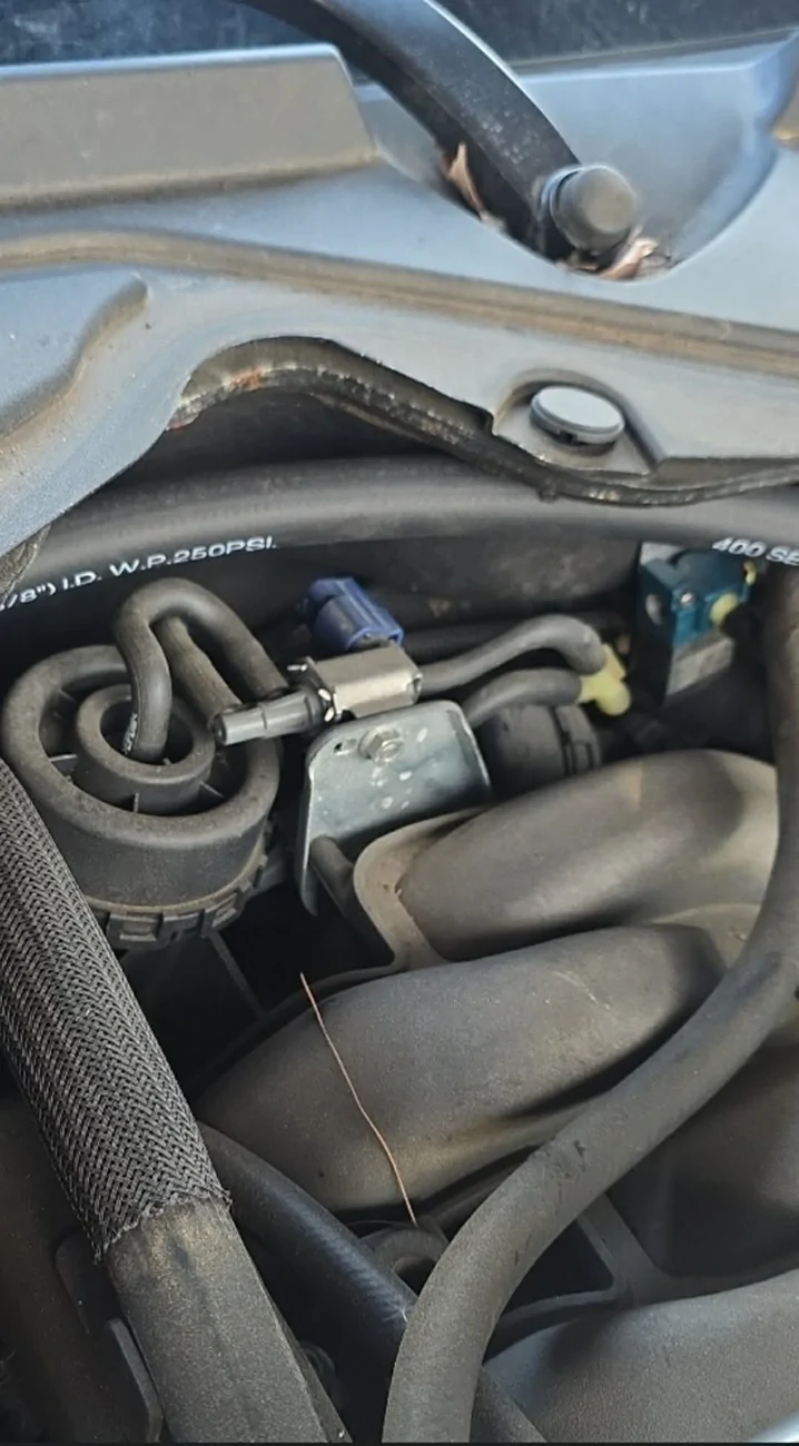

Found another missing line guess this could be the culprit?
Since the vacuum line has been missing I've been getting high rpms at idle when stopped.

Line to BOV, Mac Valve, Fuel System Regulator and another if you have a Hobbs Switch, and Boost controller
Then Brake Booster Line. Can you show the entire engine bay?
I have a similar kit.
