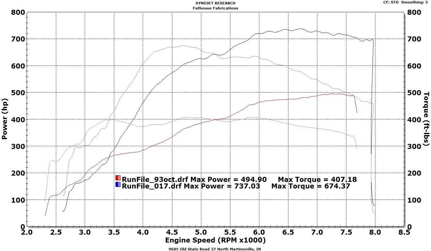

Just got the 93 Gas numbers.....
The before graph shows what she had with a tune, Kooks Headers and X pipes and a JLT intake....shows an increase of 243 HP and 267 Lbs of Tq with 7 lbs of boost! Final numbers on 93 Pump - 737HP / 674tq
Next, we will see what she does on E85! My goal is to run her on the street in the 800ish HP range with 10 or less psi on E85...

I'm curious to see if you don't get pretty close to your goal with just the fuel switch

I plan to do some road courses....will need to get some stickier tires for sure...when the boost hits..holy $hit!...need to spend some time getting used to it and play around with the boost till I find how much the street can hold and the track can hold and set the presets for each...
