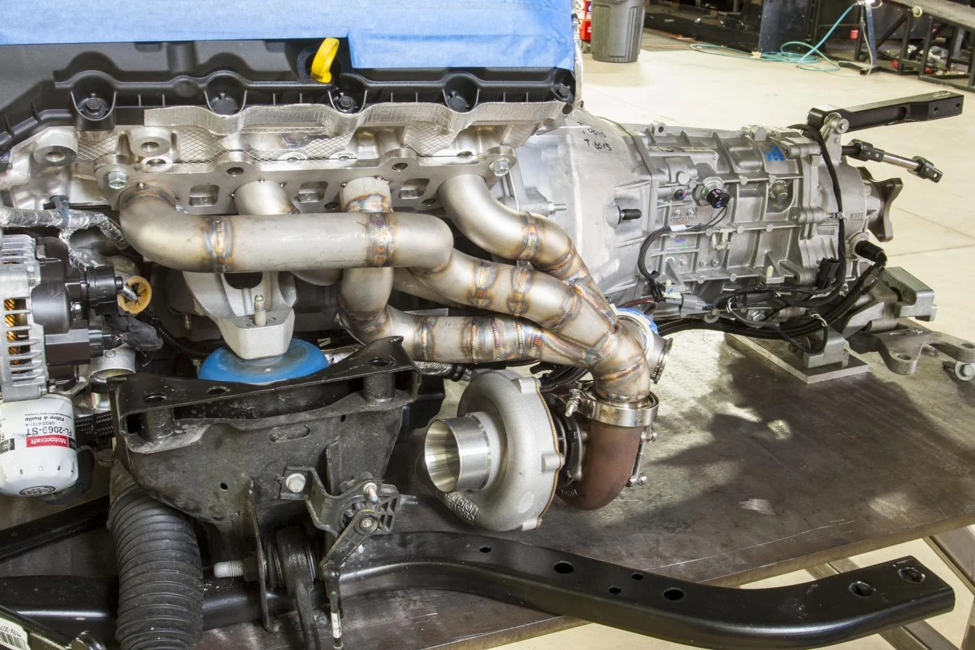

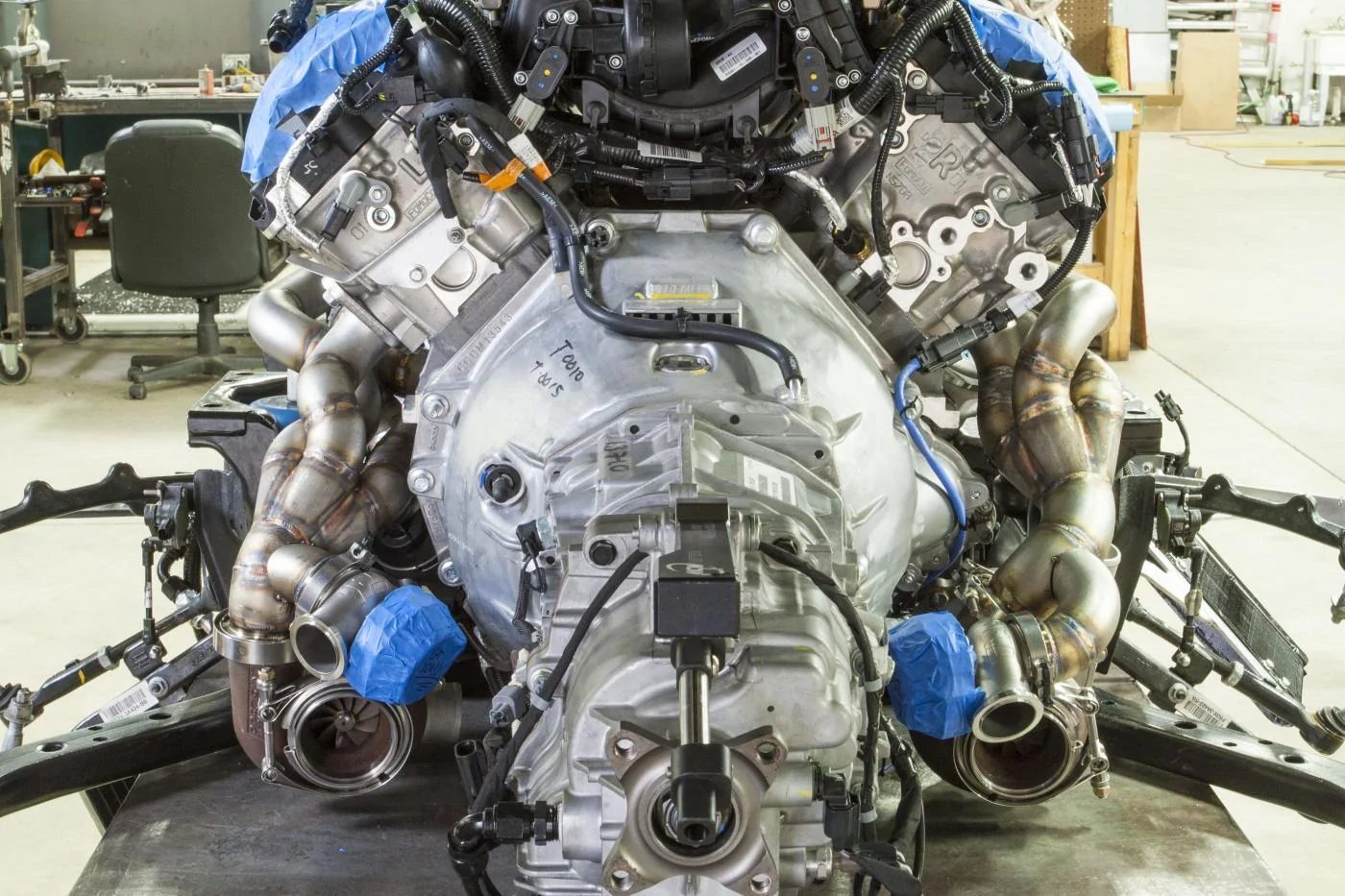

I've been getting a lot of messages from members who are interested in the progress of my twin turbo build so I figured I would share with all.
Ill try to help answer any questions I can, and I'm sure my builder, Fathouse Fabrication will chime in to help.
And please be respectful and don't forget the golden rule, If you have nothing nice to say, say nothing!
Details

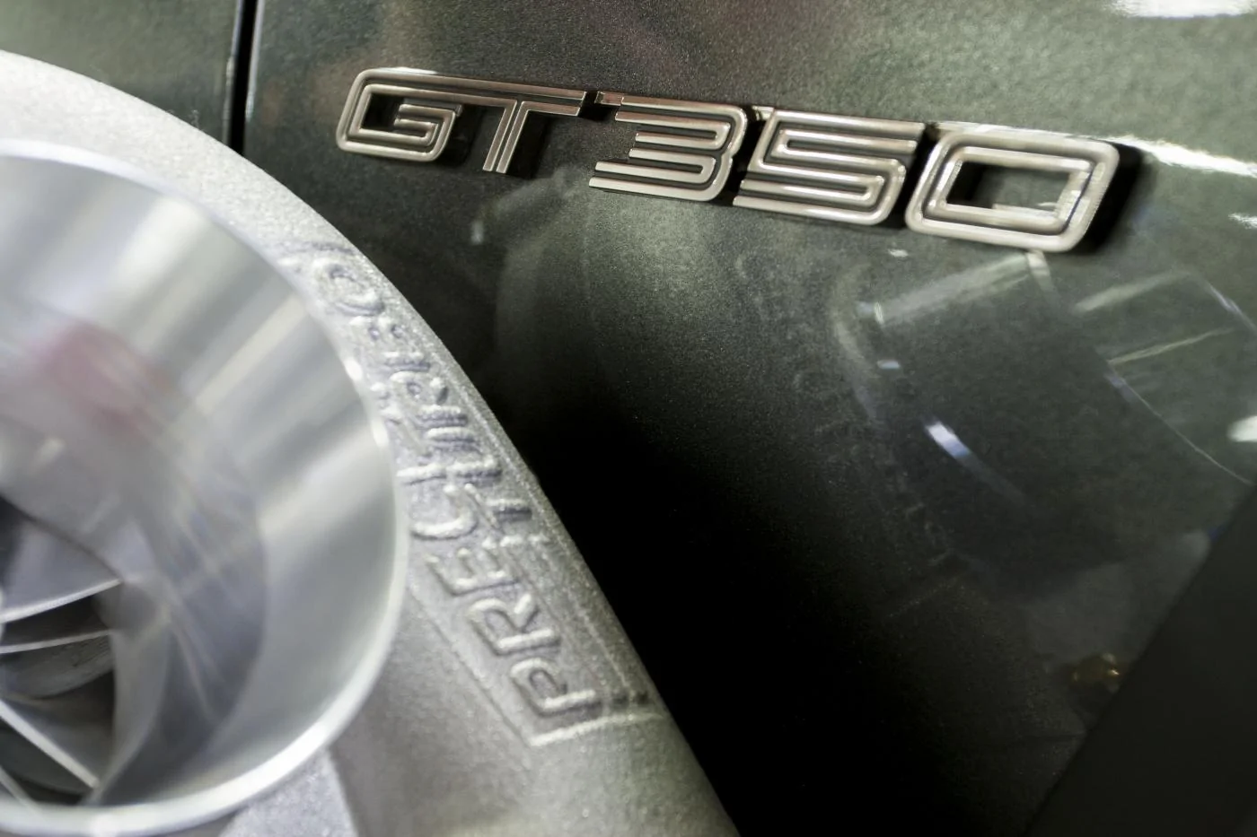

Twin Precision Turbos Gen 2 6266 Turbos! The turbos in the photos are for mock up use and not the ones that will make its home under my hood.

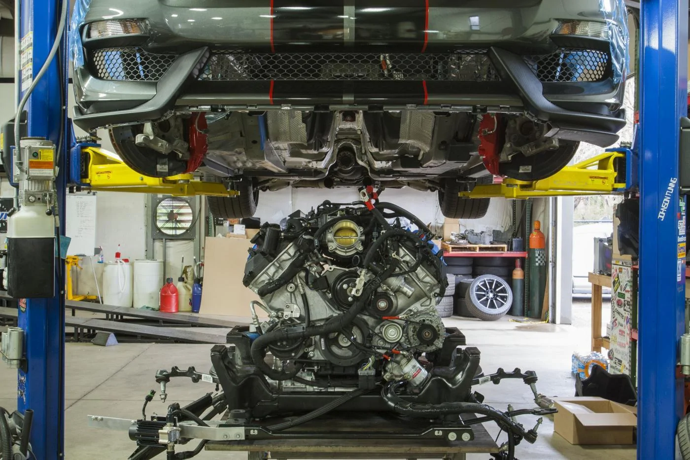

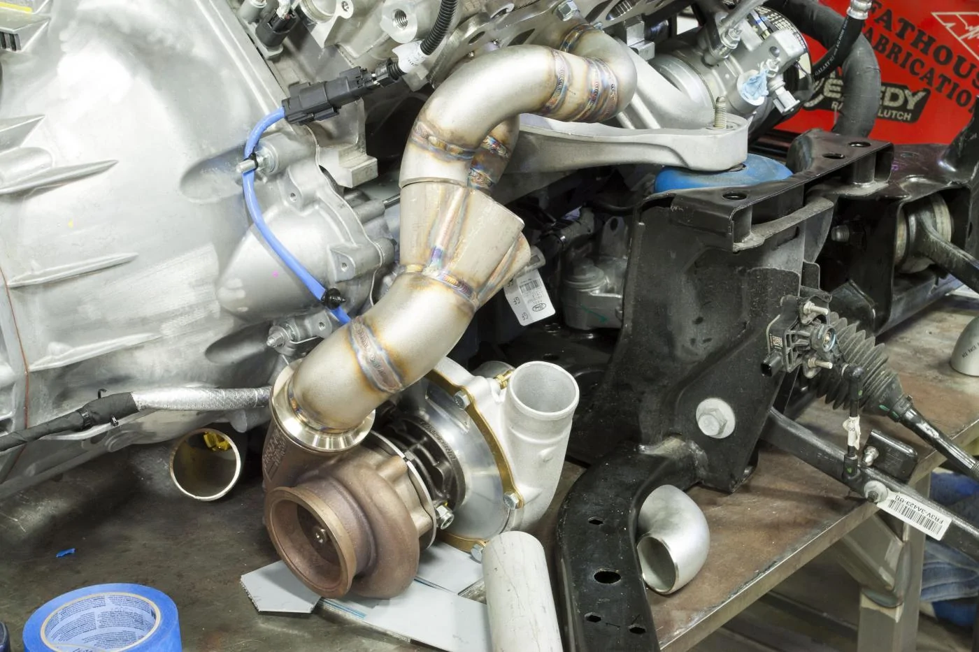

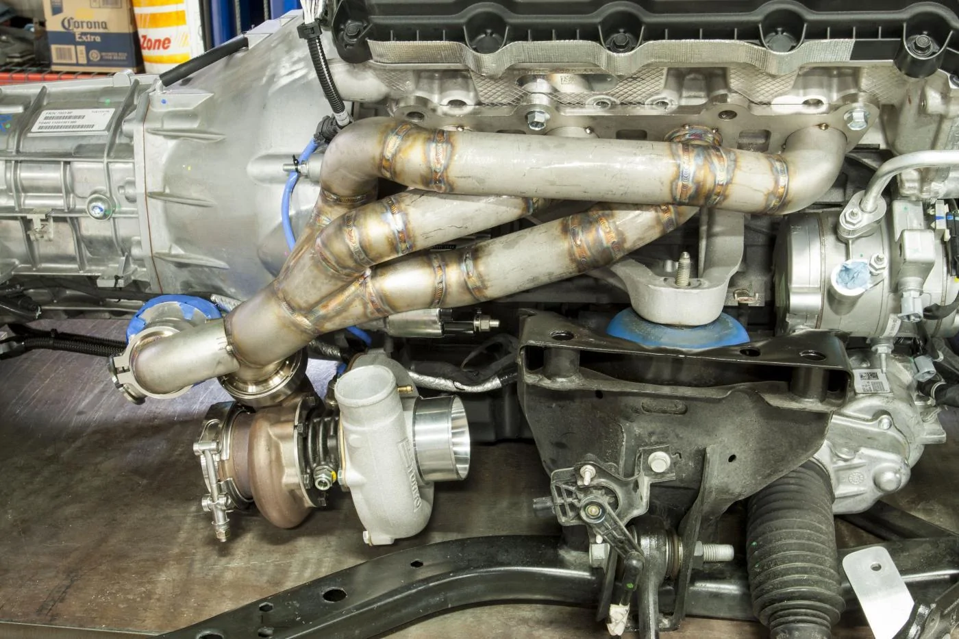

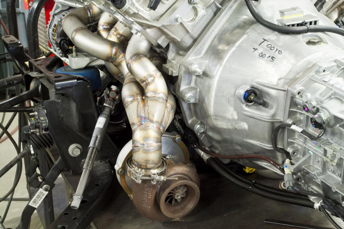

Yes, keeping the crank...hoping to run about 800hp with low boost on E85....engine is stock except for crank and oil pump gears.

I got a quote on how much to build the engine...its not cheap...I'm talking about 10-15K if I remember..Im not going to push this till it blows...so we should be able to make 800hp without carnage...
Hell ya I'm going to track it! The lower turbos will help with weight issues as opposed to having them up high infront of the engine, and I plan to put on a set of super light weight Forgelines to help offset some of the weight of the turbos...
