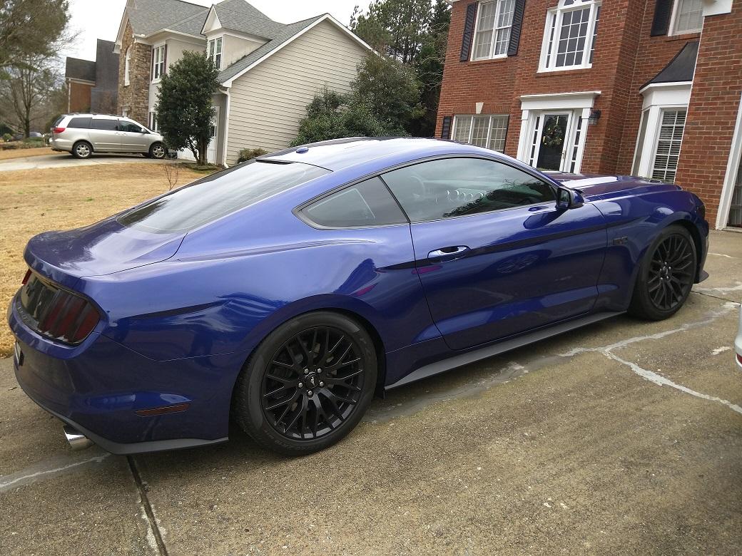

I set out 2 days with Chad to get the work done at Valdosta. Unfortunately some parts confusion on the way Kooks boxed the header pieces left us on day two with (2) driver side elbows. Here is where having a solid installer helps; Jamie & Scott mentioned they could help with getting a fab to fit if I could clear it with Kooks. I called Kooks up (and so did Terry from Beefcake) and they were good with the fit change. Shipping wait averted and I was done on my way home after day 2.5. Headers on this platform are not as easy as it looks if you don’t have experience (heads up). The gize in Valdosta know their shit and they like to engage a customer – I liked that.
Moments where you wonder if what you did was right…
1. First startup with headers and street cat-back (Woof!, grrrr, mmmmm…)
2. First drive on street then highway; OMG the shifting, set, throttle response, tone, turn, hook, feedback!
My impressions are that while I liked the car when I bought it, I am now actually enamored and have a working relationship with it. I can steer with the throttle and actually feel where the back end is going as well as modulate it. Turn in is snappy like a lighter car than it actually is, but it doesn’t tramline like a slammed civic on the highway.
I went with the KW V3 because of past experience, and the fact I was still uncomfortable with hoping someone else got the right adjustment for compression and re-bound right for me. Having the ability to weight at corners is something I really wanted, and glad I did for the future. I think these are valved differently from the Roush units based on what I read, but if the TUV can certify them they’re good enough for me. The camber plates and arms also help with that as well as cure some of the inherent ‘bump jump’ that some of the elliptical adjusters had.
For drive modes, I think my current ‘normal’ was what used to be ‘race’, but with more immediacy. Sport bumps it up some, and Race is like having a light switch for a gas pedal (it’s that snappy). This is where the Steeda Tri-Ax makes for a ‘complete picture’ – this is not the same car shifting. Although I can’t see it, I swear there’s an actual ‘gate’ down there since I know exactly where the lever goes (should have been like this from the factory, Ford ;)

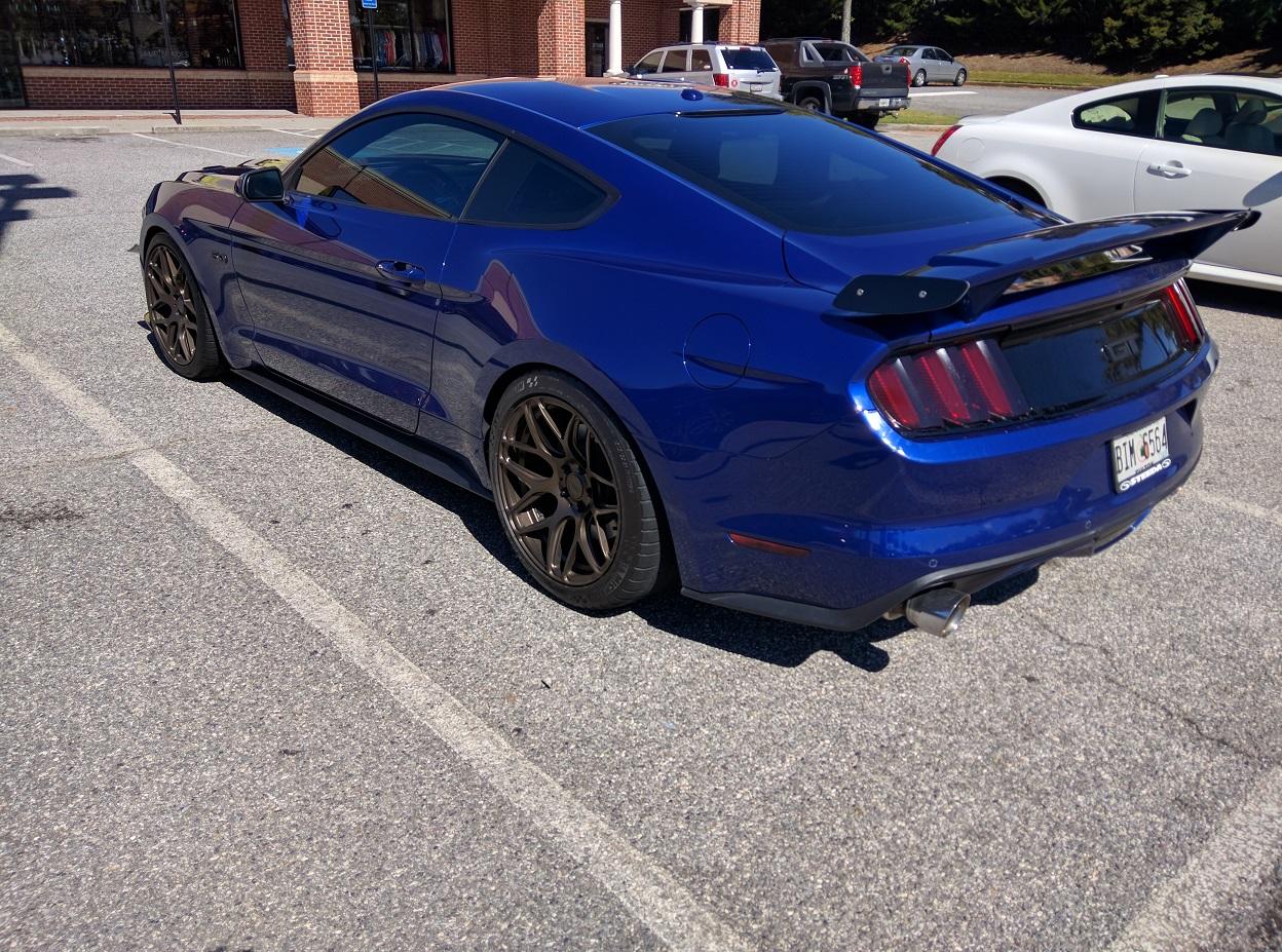

Updates 2016 summer
I finally had a chance to get into the KWv3 settings after they were installed this Feb. The ride was a bit off balance and I was curious what the 'out of the box' settings were from KW. I found that by turning compression and rebound back to full hard and counting clicks, the settings were not balanced at all (some compression was set at -2 some at -11 with no pattern). Duh!
I can't tell if this was from the product boxing or the install (where they were varied), but i recommend anyone having variable compression/rebound coilovers installed that you specifically check what you want the settings to be during the install.
I took some guidance from [MENTION=10530]MustangCollector[/MENTION] on the DD driver settings to at least have a balanced place to start from ...
> Front: Compression to full hard then backed off 10 clicks, rebound to full hard then backed off 9 clicks
> Rear: compression to full hard and backed off 9 clicks and rebound full hard and backed off 7 clicks.
After driving with new wheels (MRR FS01) and tire (MPSS), the difference in setting was night and day. Glad i went with adjustable coils, now i need to start tweeking them with some drive learnings.
Also installed a Blackvue DR650GW in dash camera for the track days. One thing I wish was that there was a place to put a camera where I could see my shift points, tach, and feet and still have a good view of turn in points on track (I'm thinking a cage would help - but its a cage).
I did order a Steeda functional race wing (@David@Steeda, please stop making kool sh!t).
Next up I need to figure out what I can do for front downforce and leaning towards the APR race splitter. Will be gettign a feel end of June with a session at Atlanta Motorsports Park on this round and if I'm good for next years time attack events in the South East.

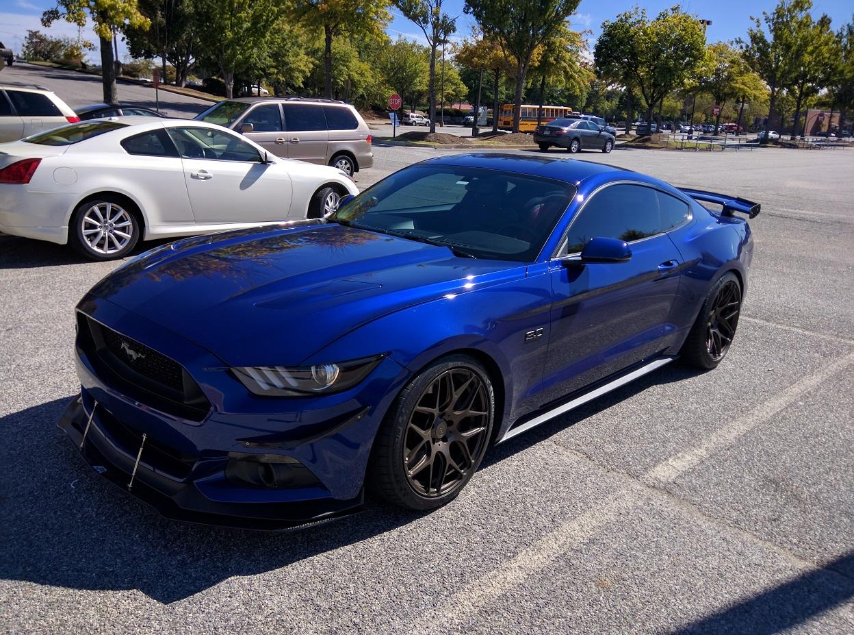

newest pics with APR splitter +canards and Steeda functional race wing
