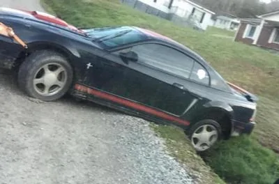

And possible this.................
Sure, if you're an idiot. That looks like an uneven gravel road. Who would punch it it? That's also a v6, those came with open differentials. Bad example mate
Dan, it was just a comical example. Ever hear of Cars & Coffee? :)
I have. I've spent a good amount of time laughing over the mustang only crash videos. I apologize if you meant it as a joke but it's a pet peeve of mine when someone, non jokingly, preaches about turning off the traction control as being the worst thing ever. Not that you were in any sense, but I couldn't tell what the intent was.
