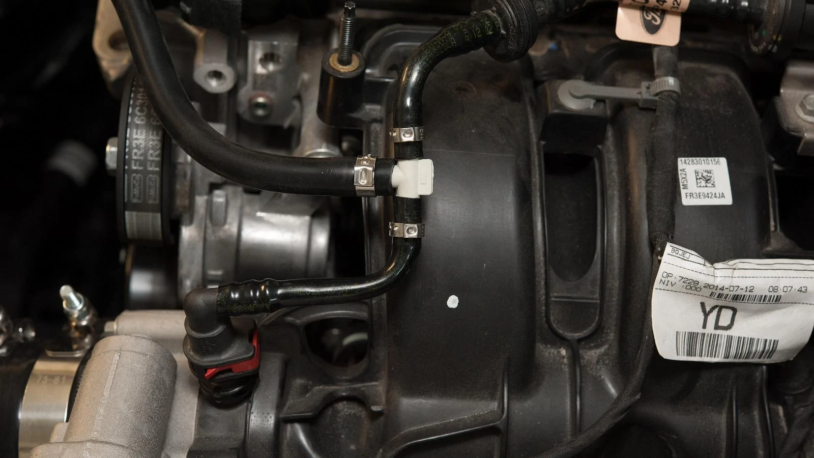

The line outlined in green is where I teed into the vacuum, the line with the orange line is the vacuum line running to the BOV
https://www.flickr.com/photos/150557396@N07/shares/z3vN93
Here is a closeup of the tee in
https://www.flickr.com/photos/150557396@N07/shares/Kg4e4k
Sorry about the URLs, I could not get the photos to embed

Not sure what line you tapped into for the BOV but it doesn't look right. Best to use the line right behind the TB and Tee into it like this...
you will need to remove the engine cover to get to this and set it up.
you can also buy the TurboSmart BOV tap they sell which does the same as the photo I posted but is a lot more bolt in and go..

I took a look at my car to compare and it appears you used the line coming out of the back of the intake. I believe that line has a one way valve or restrictor built in (round plastic piece you can see in your pics). The Mechanical valves need a Boost source with volume to operate properly.

Your problem is where you tapped into that vacuum source. Tap into the same location that PewterCam is showing in his pic and it'll work just fine. Those lines on the back of the manifold have check valves on them, and in the absence of boost pressure to operate the BOV under boost, the BOV plunger will be pushed up and vent your boost pressure.

You tree'd me, lol. I was typing my reply as you posted your reply. The line location he used is definitely the problem. It looks like he got on the side of the check valve that doesn't see boost pressure.

Thanks for the help guys, it is most appreciated. I was able to get the vacuum lines changed around this afternoon and everything is working as it should now.
