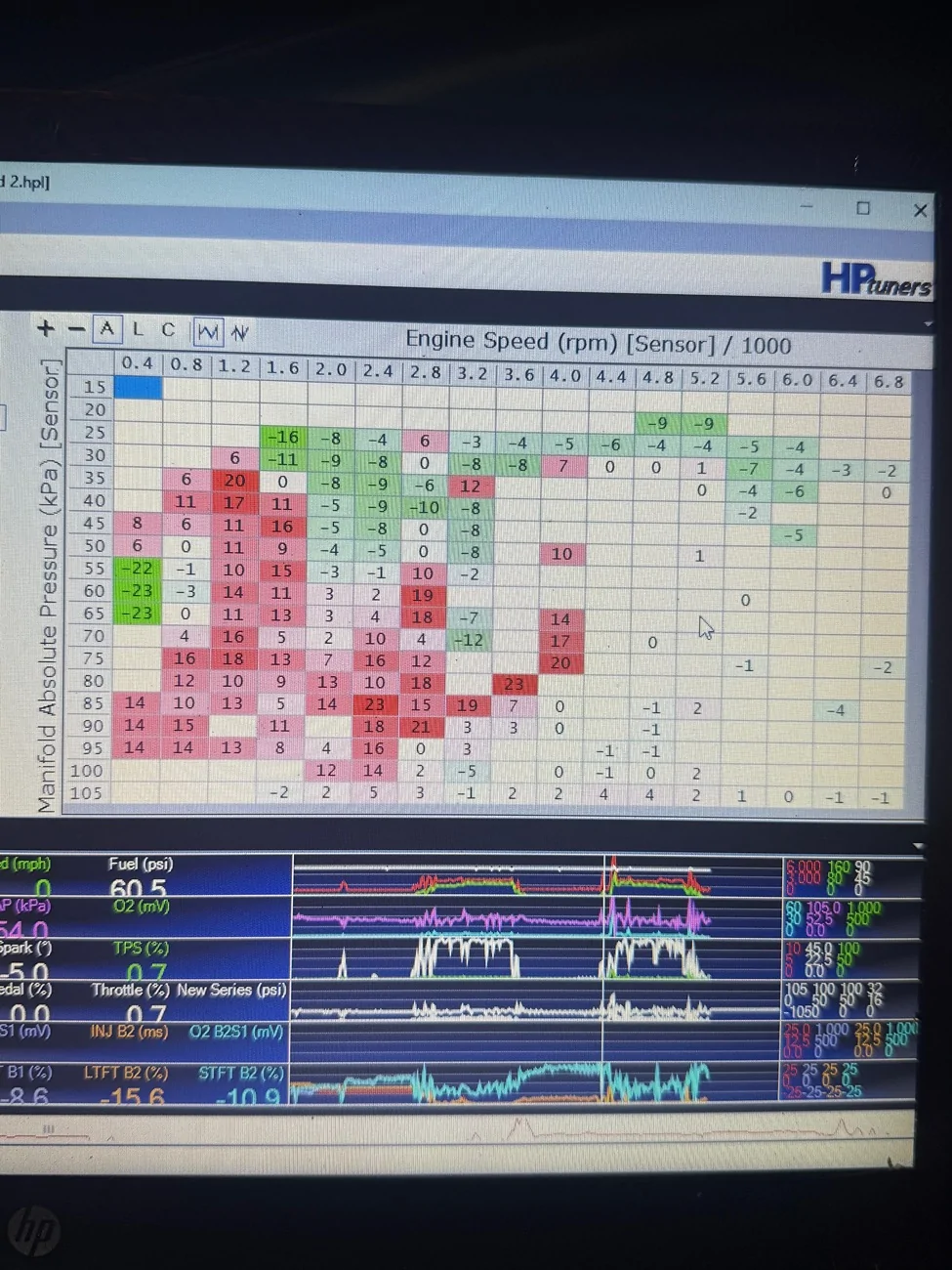

Good day all I need advice what to adjust to get this right.. it runs ok but has issues with wot and idle but no matter what I adjust it still has the same issue below is my st fuel trim average I’m assuming if I can get those numbers green it will run correctly

Right click next to MAP and select graphs layout.
Click the color window next to high value.
Select any color of green you perfer.
Im just messing around lol.
You have quite the spread of fuel trim error. Posting up the entire log file would be better as seeing the entire log file would be more insightful than a snip of the scanner with most of it missing. Many people new to this require guidance on how to setup the scanner correctly just to get logged data that you can use to adjust the calibration file with.

So... which table are you trying to adjust here?
I like the right click idea!! I will upload the log I do like the pops and crackles I’m getting right now tho and my knock is 0 the idle is erratic and the throttle hangs… for you sir who seems to knows a little something do I have to adjust the maps? To get this fuel trim right all I’ve done so far is mess with airflow and idle stuff I did not mess up a perfectly good time something like that I actually ripped most of this from another and put a Whipple on and this is where I’m at just trying to get it dialed in as they say

Work with ChatGPT - it'll get you along the right track for basic clean up and asking questions

There's a write up on HPT forums on what to do...
