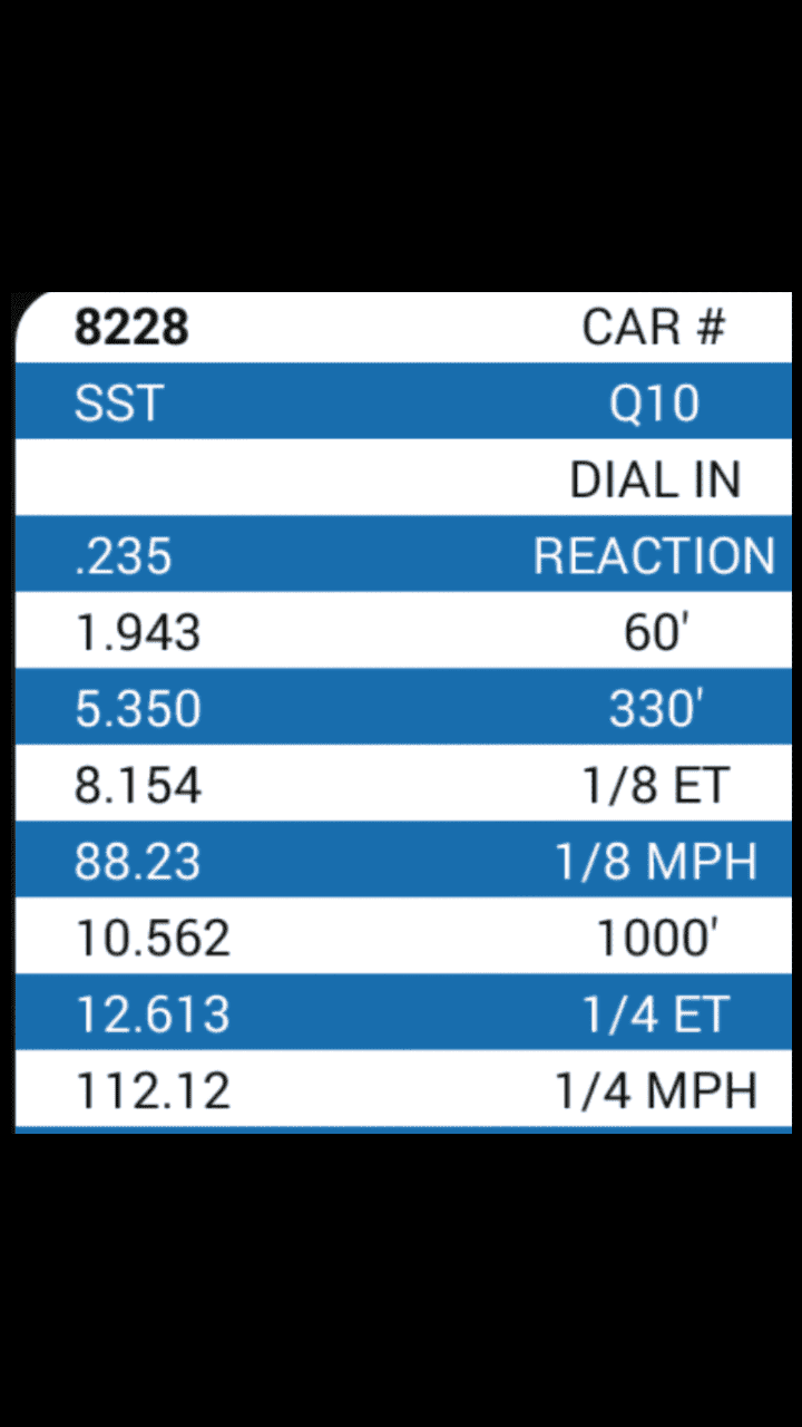

I'm 63 and race my Ecoboost Mustang on the 1/4 mile drag strip. Air, Fuel and a Ford Performance tune will get you into the mid to high 12 second range and around a 110 mph.
