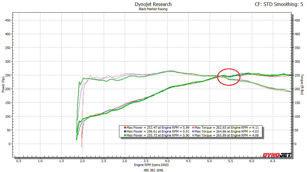

MPT and I still could not figure out the single knock at 5500rpm. It happens in each gear at the same RPM and stops. We tried it with the stock tune and with 100 octane with the stock and 91 tune, still there. On the dyno you can see the drop. It drops 10hp and makes up 20hp after. If I didn't have that drop it would have probably made 275-280+hp?

Anyone have any ideas about that knock at 5500RPM? Diagnosing options?

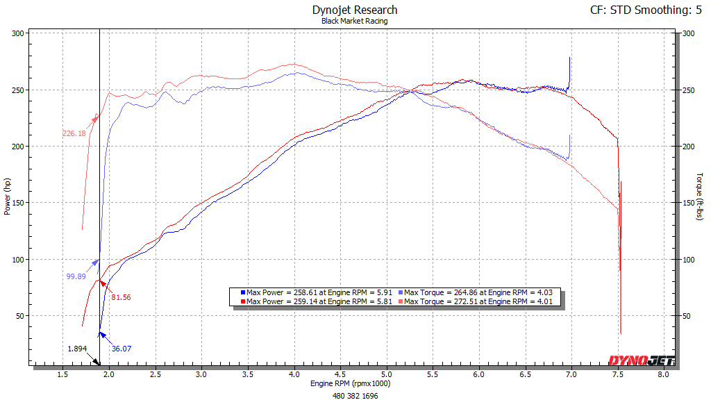

Here is a new dyno with GT throttle body added and updated tune and the last dyno sesion. I pulled the "Dyno Plug" but it appears that that wasn't affecting the last dyno. I still have the (false?) knock at 5500 RPM, but it wasn't pulling as much timing this time. I assume it's a resonance from something at that RPM? I've checked everything I could reach, and used a borescope to look around the intake/heads for any loose bolt or nut.
I think this is kind of low results for a nearly FBO - MPT 91-PRX tuned 3.7. (FBO with shorty headers and stock intake manifolds) I didn't port my intakes because there was no more than a finger nail thickness at the seems and the lower was basically port matched to the heads except for very corners of the ports(also about a finger nail thickness).
Every other N/A 3.7 dyno sheet I've looked at has more HP than Torque, but mine is reversed?

How much slop is there in the cam timing from the factory? Maybe yours are advanced
