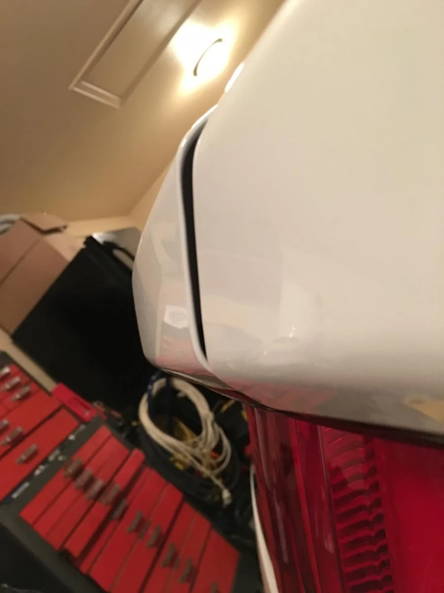

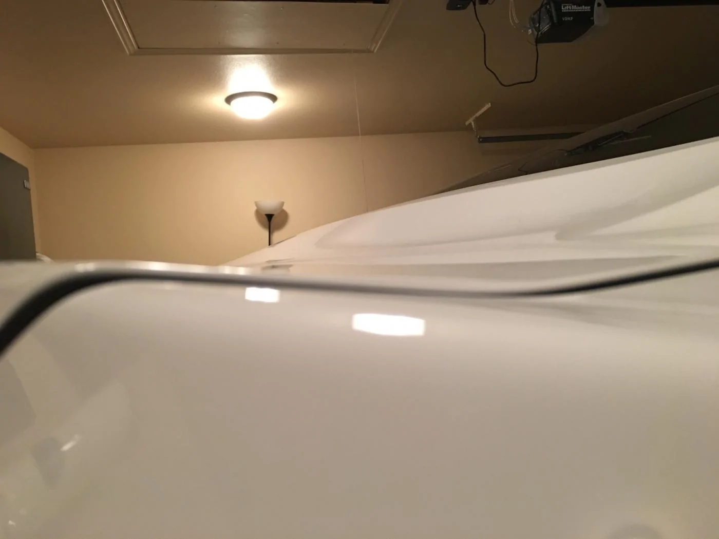

Yours is little waay off to one side. I have it too with probably most of everyone else but not that bad. Is the trunk lid itself off as well, doesn't look like it in the pic?do you s550 owners have a gap on the ends of trunk lid by tail lights, seen alot with this, check yours out, thanks![]()
ugh my trunk lid seems to line up just fine, but the plastic panel is a different story... it dosen't line up with anything :(
The left rear quarter panel on these cars are shall we say, off spec a little.Me too!
The left taillight needs to be shimmed outward with .060 washers; 1 washer on the quarter panel stud side and 2 washers for each stud on the trunk lid side. Near perfect after that...at least on mine.
