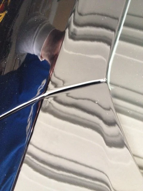

I had a terrible squak every time I opened my trunk. I looked it over closely today to find the source. I saw a couple places where the front driver's side edge of the trunk lid is rubbing the edge of the quarter panel by the back window each time I open it. I guess I will have to bring it in before the paint gets rubbed any worse. Just thought I would share in case anybody else's makes noise when you open the trunk.

Mine did the same thing i loosened the nuts on the hinge and adjusted and touched up the nick its not even noticeable. Def sucks on a new car but was an easy fix
