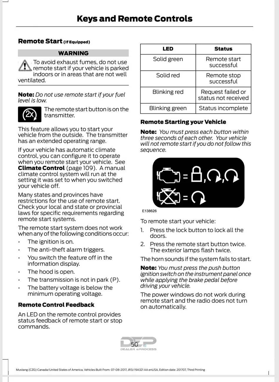

Please advise…what is the proper sequence of pressing the buttons on my key fob to remote start on my 2022 Mach 1 ??
(Saw it done once but… I must not be doing it right…help…)
Thanks in advance for your help..

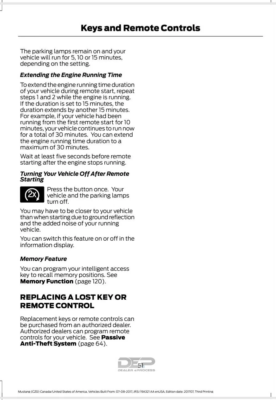

From my '18 owners manual. Can't think it would be different for any other model/year.

Lock doors on remote then press remote start button twice
