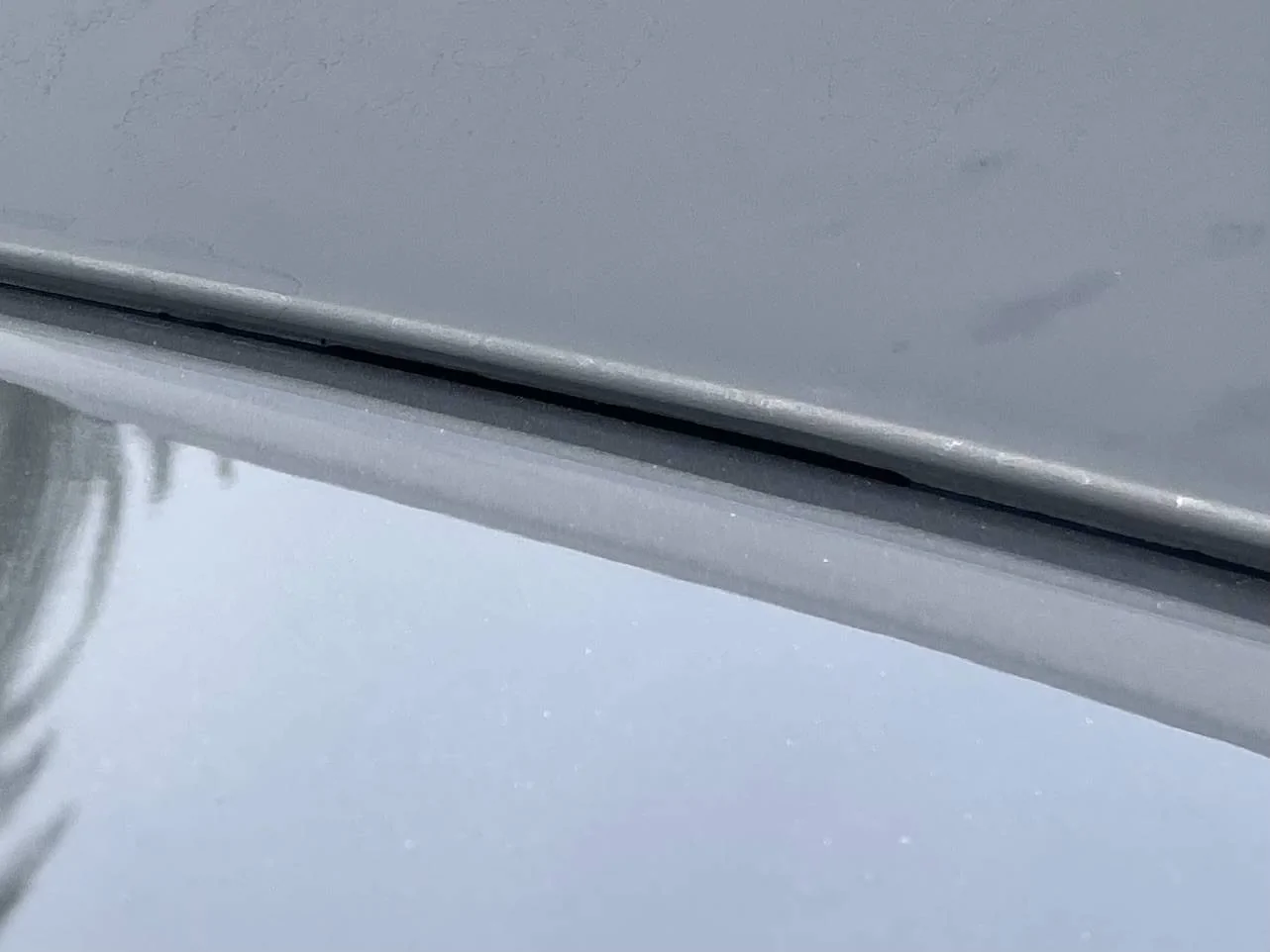

not to thread jack but I am running into the same issue…
bought a Drake Muscle Cars spoiler from AM and installed yesterday.
my car came with the small blade style spoiler and in hindsight, when removing the stock spoiler, I didnt cover over the unused holes assuming that new tape around the perimeter of the spoiler would be sealed up?!
I used a rubber wheel to remove all old adhesive; cleaned with adhesive remover and alcohol then wiped with adhesive promoter right before installing the new spoiler.
I installed the new spoiler, bolted it down and checked a couple hours later.
on the front edge I found a few spots where the adhesive looked to have a slight gap and did not stick down
(maybe 3-4 spots at about 1/2” each at most)
so, being neurotic I unbolted the spoiler and tried to pull up on it and it was really on there so I decided to tighten back down instead of possibly damaging the spoiler or my trunk in the process of pulling back off
I pressed the heck out of the edge of the spoiler and it looked to stick. 🤔
checked today and damnit if those spots didnt reappear.
and of course it rained a lot today and when it stopped and I went out and pushed down on the front edge, some little bubbles appeared in one of the spots where it didnt stick 😩
I’m a bit worried about trying to pull all that off and getting myself into a real mess so I ordered some DAP automotive RTV Silicone (clear) that comes with a very small tip.
https://a.co/d/3LLtAUp
I figured I would run a small bead up under the front edge of the spoiler to seal it off; then run a small plastic tool under to make a clean seal.
Anyone else done this?
Thoughts?

True, it had about 1/4 or 3/8” width tape.
I assumed that having the 4 mounting points would pull it down but between trunk shape and any ABS molding offsets, I guess I could end up where I am.
Maybe this is also what happened with the OPs install?
I just went out and of course its up a tad more in areas and I’m sure the rain didnt help.
I had bought some 1/2” VHB 3M tape but figured it might be overkill if I installed so I only applied a few small strips in addition to the stock adhesive.
I would really hate to have to go through the trouble of trying to get that thing back off because the parts that did bond seem to be really on there.
attaching a pic of a gap in the adhesive bond
It looks like where the mounting posts are that it pulled that down good.
Could I have over torqued and caused bowed up areas where no bolts?
what a pain 🤦‍♂️
what a pain 🤦‍♂️
On the Drake spoiler, I pulled the original tape off the spoiler and put new tape all the way around and also around the decklid holes. Unless there’s a specific torque value in the instructions (I don’t recall on the Drake), hand tight is usually good enough. Most of them come with nylon nuts so they’re not going to back off.
