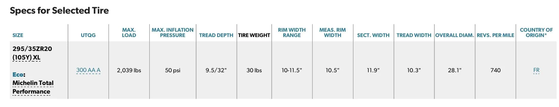

Could it possibly be related to rim width. Michelin recommends 10”-11.5” for a 295/35-20 tire. Maybe a wider wheel would help.
