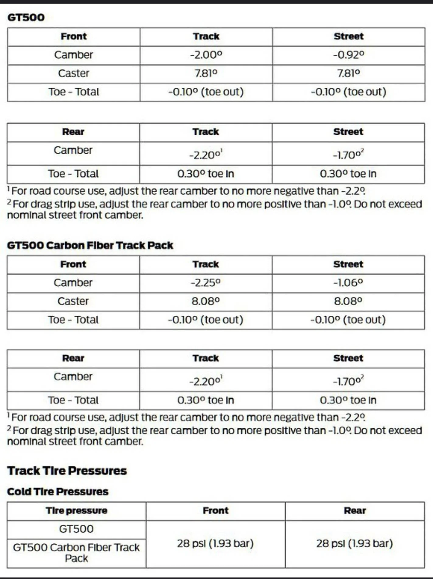

Preferred track alignment?

2017 GT350R, 1966 Couple (347 Stroker)
Beauty. Thank you.
