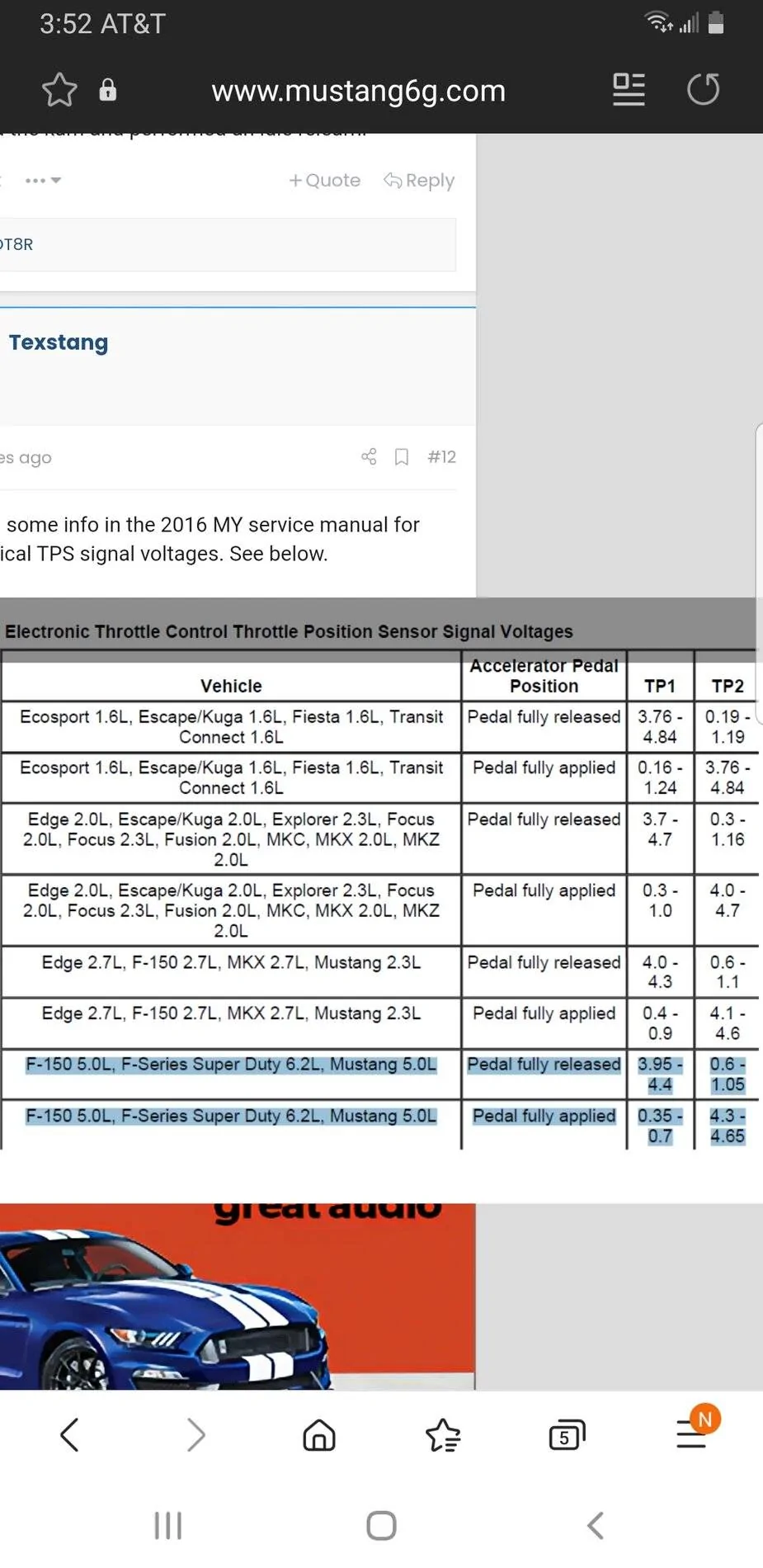

Does anyone have a factory service manual that can tell me what the TPS voltage is for a closed and open throttle blade? I need this information to program my nitrous controller. Thanks

Got it figured out; at least for my Bullitt, TPS voltage read 0.7V with the throttle blade closed and 4.3V with throttle blade fully open which is showing 99% open on my nitrous controller display screen.

Mine reads
0,76v released and 3.99v applied
Is that correct ??
