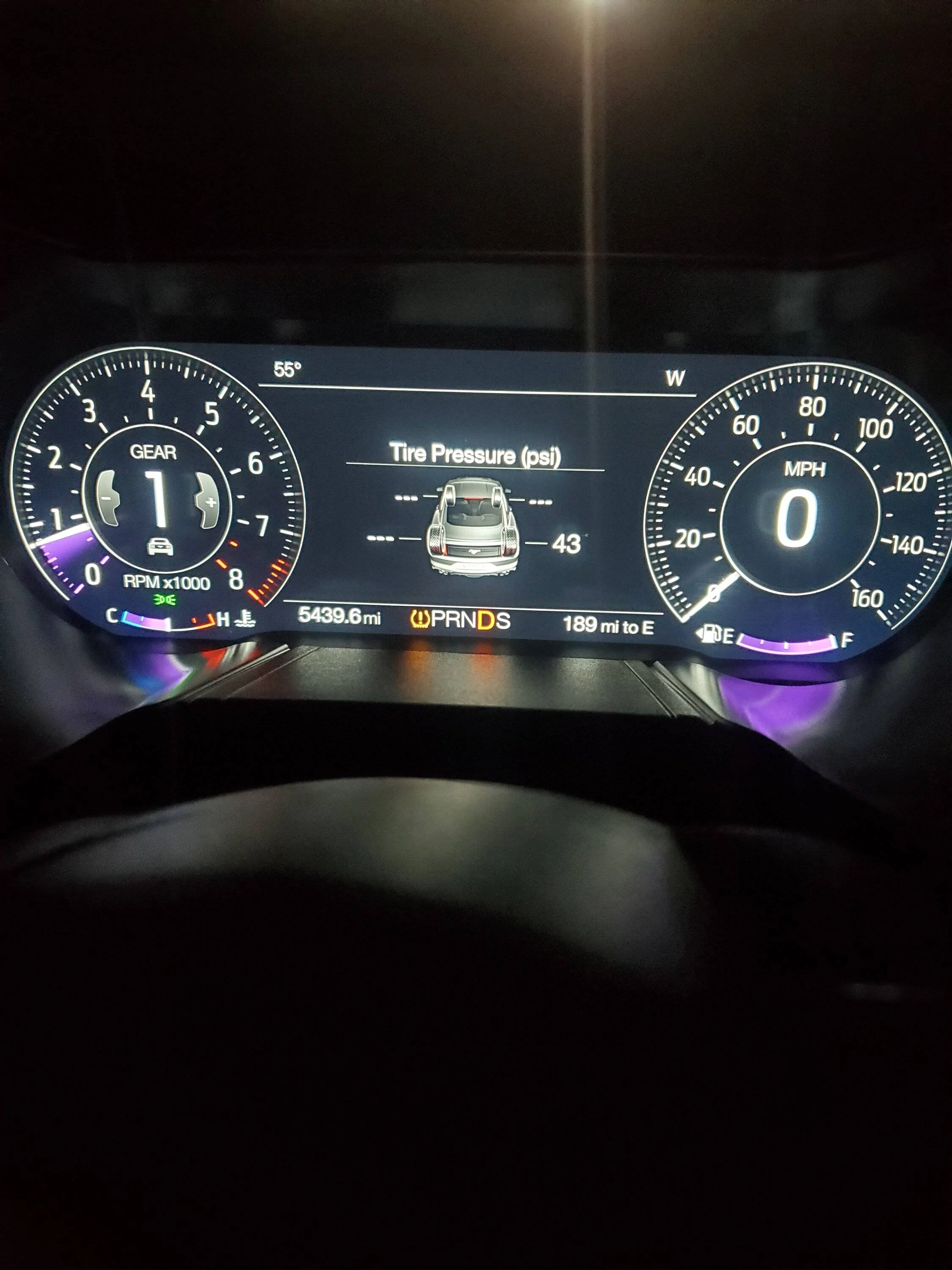

Yeah the original ones aren't connecting anymore & it's the same 3 failing from the attached picture. It crossed my mind that they might of gotten mixed up but the tire shop guy is an honest guy & was careful when doing the job. He claimed he has done other mustangs & never went through what we went through.

That was my argument from the beginning with the other sets we tried. We went through 3 sets & all had similar issues. In the end we installed the stock ones & the issue still keeps happening now with the stock tpms. He thinks it might be the module that reads them. When I start the car they all read & the pressure is correct. It's only after a short while of driving that 3/4 stop reading, go blank, & light comes on.
