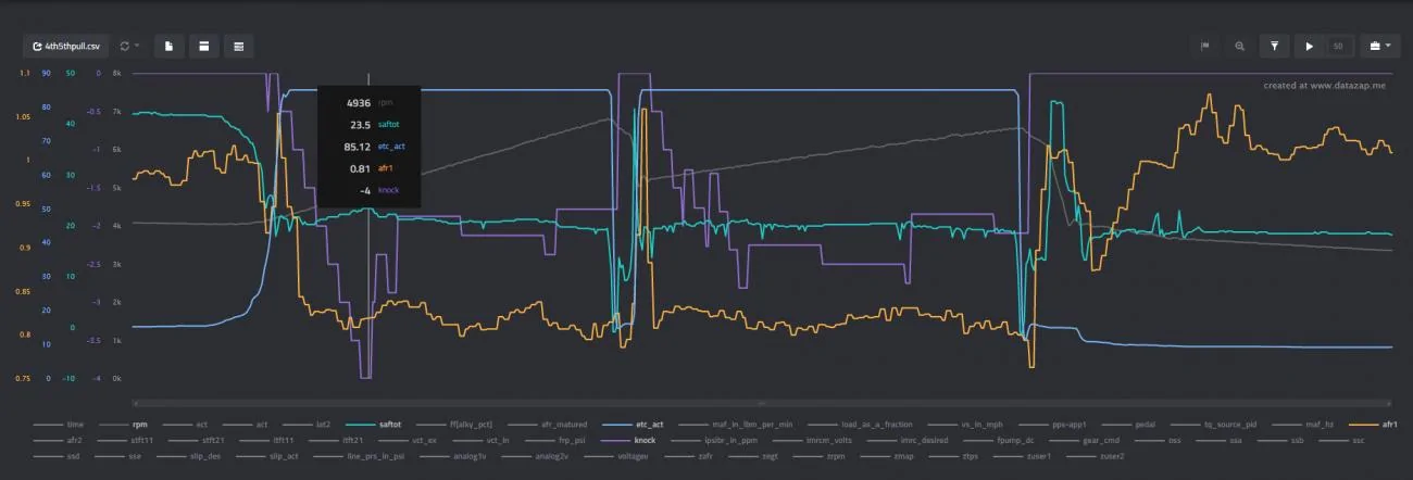

ok, I'm officially an idiot. I was looking at wrong file. So, I made a pull about 30 minutes ago, up a pretty decent hill on the highway. Started at 4000rpm in 4th and wound it out through 4th and 5th.
Looks like 20-21 total timing. lambda 0.80 - 0.82
This is a great log. fuel is pretty good.
Your knock advance actually runs you into knock at 23.5*(-4 to -1.8 is positive) and then the car pulls back to 21*. You could probably run 22-23* with out it doing this. On bad fuel it probably makes it worst. After Three knock events(even the .5* zero intensity ones) you are switched from the fast knock advance to the normal knock advance which is half the speed. You can see this by how much slower it goes negative after these events. evident this happens in both gears. limit the advance to -2.5* and getting rid of this unnecessary knock should help add some more power.
Just as procharger said "If you allow them to add to much, then the computer has to back pedal and pull it back out. You can end up with a bit of an odd power sensation, and well if she doesn't pull fast enough....boom"
If this is their tune its still allowing too much to be added.

Thanks for looking over the log. Thats with sunoco 93 and a can of octanium added to the full tank.
Yes, that is with the stock procharger tune they emailed me.

Thank you for posting the log. I was mainly curious about the VCT. Since this is a octane boost thread I also wanted to see how that was working. I have been hearing a lot of positive feed back from people using it lately. It definitely helps, but I still think tune revisions can help as well if the tuner knows what to look for. Prochargers got a really good tune on your car much better than some logs from other tuners I have seen including what I have seen on my own car from others.
